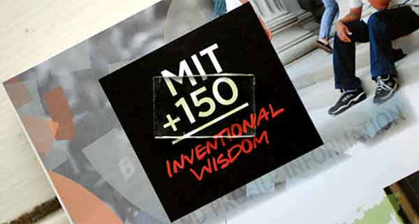

Now, Richard Lunt and Vladimir Bulovic of Massachusetts Institute of Technology have turned the exciton problem on its head. They exploit the fact that the formation of excitons alters a material's absorption properties. So rather than absorbing wavelengths more or less equally across a broad spectrum, as is the case in silicon, their prototype cell instead displays distinct absorption peaks. By combining the organic molecules chloroaluminium phthalocyanine and carbon-60, their cell absorbs light at infrared and ultraviolet wavelengths but has limited absorption at visible wavelengths. In other words, it is able to extract energy from the non-visible parts of the spectrum while leaving most of the visible light free to propagate.
The fact that the new device does not absorb appreciably at visible wavelengths makes it less efficient than opaque organic cells. However, say Lunt and Bulovic, it is more efficient that other kinds of transparent cell that absorb across the spectrum. As they point out, these other cells must be made very thin if they are not to become opaque and as a result have efficiencies of less than 1% when at least partially transparent. In contrast, they achieved efficiencies of up to 1.3% when transmitting at least 65% of the incident visible light and up to 1.7% for transparencies greater than 55%.
