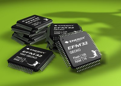

Energy Micro, the energy friendly microcontroller company, has announced availability of its EFM32 Gecko and Tiny Gecko product lines in a QFP64 package. The new 64-pin devices are particularly popular in the growing smart metering market, in addition to energy sensitive applications like building automation, security systems and portable health and fitness equipment.
Energy Micro adds 12 devices to its Cortex-M3 microcontroller range for energy friendly applications
The introduction of the larger I/O count package adds 12 new product variants to the company’s ARM® Cortex™-M3 based microcontroller portfolio. The EFM32G232, EFM32G842, EFM32TG232 and EFM32TG842, which are available in various configurations of Flash memory ranging from 8 to 128 KB and RAM from 2 to 16 KB, offer the same energy saving Gecko technology as other package options in the EFM32 MCU range. In application benchmark tests, this low current performance, combined with a wake-up time of 2µs has enabled the EFM32 microcontrollers to extend battery cell life by a factor of at least four.
