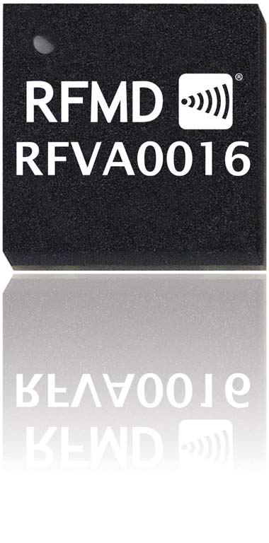

RFVA0016 Analog Controlled Variable Gain Amplifier 400MHz to 2700MHz
RFMD RFVA0016
RFMD’s new RFVA0016 is an integrated, analog-controlled, Variable Gain Amplifier (VGA) for broadband applications with external matching, allowing operation in all bands from 400MHz to 2700MHz with a single module. It features exceptional linearity, OIP3 > 40dBm, and provides a >30dB gain control range. A mode logic pin enables the VGA to be selected for either a 0V to +3V or a +3V to 0V analog-controlled attenuation slope. The RFVA0016 is packaged in a small 5.2mm × 5.2mm leadless laminate MCM with thermal vias for ultra-low thermal resistance, and is external matched to 50Ω at each individual band.
