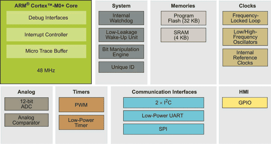

Kinetis KL02 CSP MCU Family Block Diagram

The Kinetis KL02 is a wafer-level chip-scale package (CSP) MCU. Freescale’s CSP MCUs use the latest in package manufacturing technology to connect the die directly to the solder ball interconnects and, in turn, to the printed circuit board (PCB). This removes the need for bond wires or interposer connections, which minimizes die-to-PCB inductance and improves thermal conduction and package durability for physically harsh environments. The KL02 device is the third CSP MCU in the Kinetis portfolio, joining the larger 120/143-pin Kinetis K series K60/K61 variants. Additional Kinetis CSP MCUs with increased performance, memory and feature options are planned throughout 2013.

  • 48 MHz ARM Cortex-M0+ core, 1.71-3.6V operation
  • Bit manipulation engine for faster, more code-efficient handling of peripheral registers
  • 32 KB flash memory, 4 KB RAM
  • High-speed 12-bit analog-to-digital converter
  • High-speed analog comparator
  • Low-power UART, SPI, 2× I2C
  • Powerful timers for a broad range of applications including motor control
  • –40 °C to +85 °C operation
