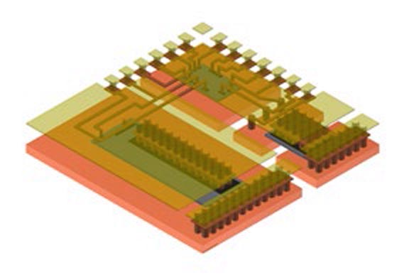

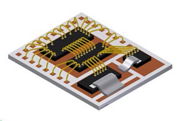

Infineon`s highly innovative Blade packaging technology is based on chip embedding concepts. Standard packaging processes like wire or clip bonding, as well as common molding techniques, are replaced with galvanic processes. The die also is protected by a laminate foil. The results are a significantly reduced package footprint, package resistance and inductance, as well as low thermal resistance.
Packaging Technology Comparison: Conventional (left), Blade (right).

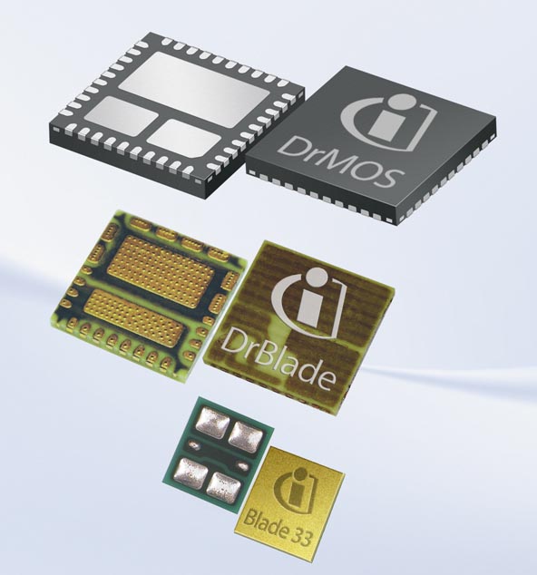

Saving space and gaining efficiency
The DrBlade package measures 5×5mm and has a low profile of 0.5mm, fulfilling demand for higher power density and space saving in computing systems. Due to the optimized pin assignment DrBlade enables a simplified PCB layout. The new chip-embedded packaging technology in combination with OptiMOS MOSFETs by Infineon makes DrBlade the best solution for voltage regulators in the low-voltage segment.

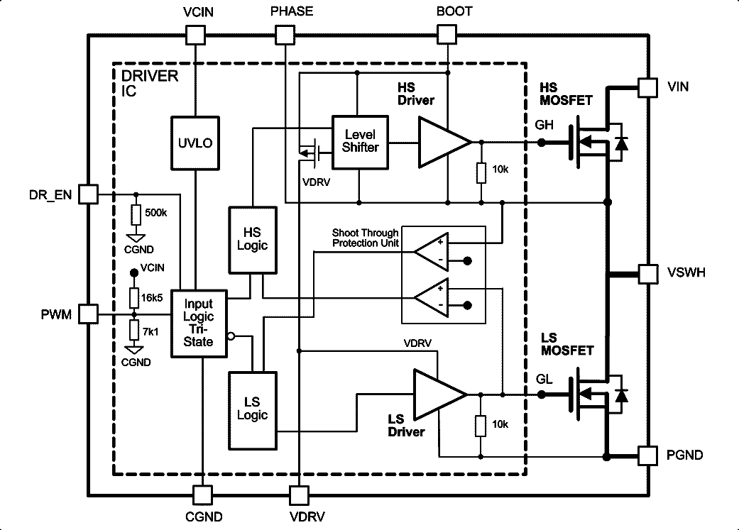

DrBlade Simplified Block Diagram
Simplified Block Diagram.
