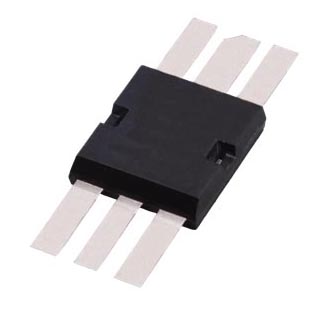

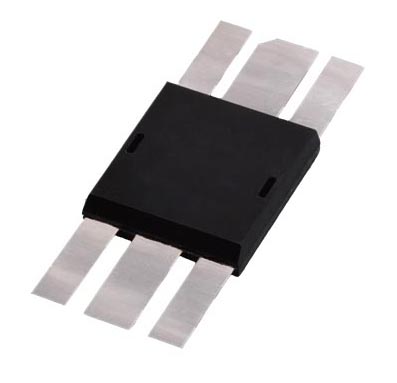

IXYS Corporation announced the introduction of the SS150 and SS275 Series High Power Silicon Carbide (SiC) Diodes by its IXYS Colorado division. Three diode configurations provide designers with flexible connection and layout options. Packaged in our low inductance, surface mount DE Series package, these products provide excellent switching performance.

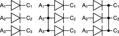

The SS150 and SS275 are both available in 600V, 10A and 1200V, 5A ratings. Standard internal configurations include:
  • TI – Triple Independent – no common connections
  • TA – Triple Anode – anodes are tied together
  • TC – Triple Cathode – cathodes are tied together
