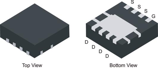

The DMN3027LFG is offered in a PowerDI®3333 package, which has a low thermal resistance from junction to exposed pad of <10 °C/W enabling the dissipation of up to 3 W.
