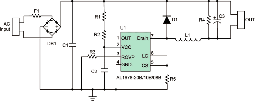

The AL1678 Typical Applications Circuit
The AL1678 Typical Applications Circuit.
The AL1678 LED drivers’ total BOM lamp cost is low because it removes the need for an external high-voltage MOSFET and an auxiliary winding, while requiring only a single external inductor. Integrated protection features include under-voltage lockout, over-temperature protection, LED open- and short-circuit protection, as well as a thermal fold-back function to help improve the system reliability of retrofit LED lamps at high temperature. The AL1678’s SO-7 package also helps improve electrical isolation and offers improved moisture resistance.
