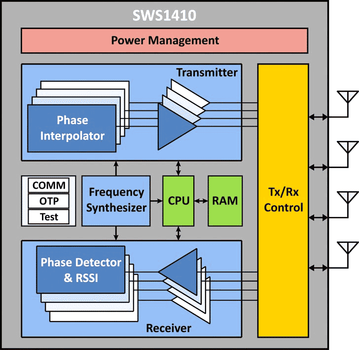

The SWS1410 Cota transmitter is a MIMO transceiver that implements two main functions within the Cota system: detecting the location of the receivers from one or multiple devices, and transmitting the focused power to those devices through a multipath radio frequency in the range of 2.4 GHz (which the company claimed works nicely with other Bluetooth devices and doesn't interfere with them).
The SWS1410 transmitter chip
The SWS1410 transmitter chip.

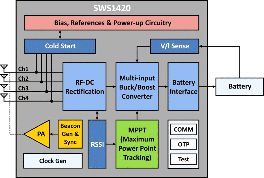

The SMS1420 receiver also implements functions in the Cota system: receiving, rectifying and converting RF power into DC current to charge the devices' batteries, and transmitting a synchronized beacon signal to the charger to help it locate where it should send the power. The receiver can support a wide range of RF power delivery, from 100 mW to 10 W.
The SWS1420 receiver chip
The SWS1420 receiver chip.
