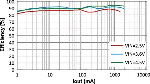

In response, the BD1865GWL features a lower operating limit of 2.5 V, prolonging battery life in devices by extending operation down from the conventional 2.7 V. In addition, two operating modes are built in, PWM/PFM mode and ROHM's original mixing PWM mode. The former ensures up to 90% efficiency across all load regions, while the latter prevents unwanted switching noise in audio applications. The BD1865GWL is also capable of delivering output currents up to 2 A in a compact 1.6 mm × 1.6 mm package, contributing to greater end-product miniaturization.

    This mode automatically switches between PFM and PWM modes based on the load, ensuring high efficiency throughout the entire load range.
  • Mixing PWM Mode
    An original control method that provides higher efficiency than typical PWM at light loads and prevents unwanted audible noise from being generated during switching, making it ideal for high fidelity audio systems.
