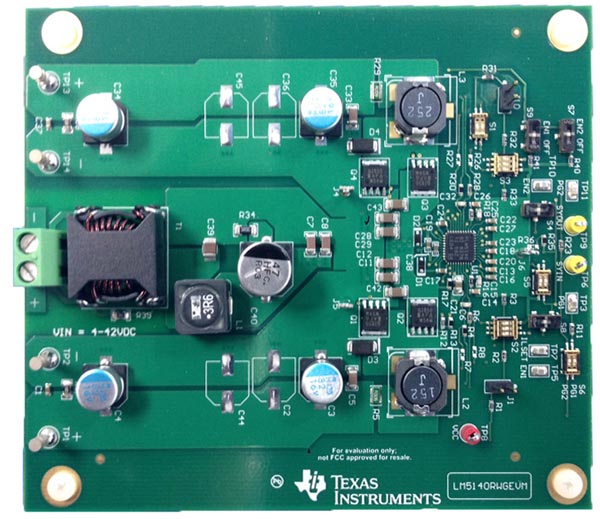

The LM5140RWGEVM evaluation module
The LM5140RWGEVM evaluation module.
