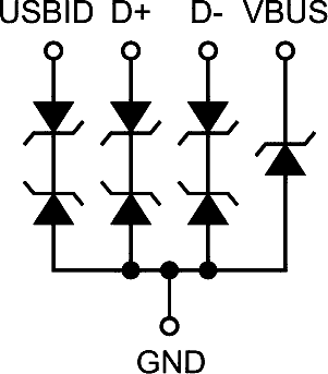

The D5V0F3B6LP20 integrates three bi-directional I/O channels and one VBUS channel, which provides 3.2 kW of lightning surge stress protection for the VBUS power line, with a peak pulse current (IPP2) up to 80 A in compliance with IEC61000-4-5 requirements. A low 0.4 pF input capacitance on the I/O channels ensures compatibility with high-speed data ports such as USB 2.0 OTG (on-the-go) and the device is also capable of supporting USB 3.x data rates.
