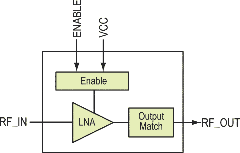

The SKY65623-682LF is a Microwave Monolithic Integrated Circuit (MMIC) front-end low-noise amplifier (LNA) designed for Global Navigation Satellite System (GNSS) radio receiver applications. The device provides low current consumption, excellent gain, and a superior noise figure (NF). Output matching components are embedded inside the device. Only one external input matching inductor is required.
SKY65623-682LF Block Diagram
SKY65623-682LF Block Diagram.
