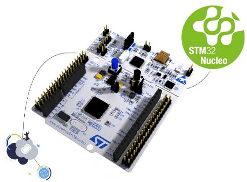

The development ecosystem includes the STM32CubeMX initialization-code generator and STM32CubeL4 package comprising middleware components, Nucleo-64 Board-Support Package (BSP), Hardware Abstraction Layer (HAL), and Low-Layer APIs (LLAPIs). STM32CubeMX has a power-estimation wizard that assists low-power design and additional wizards for managing clock signals and pin assignments.
The Nucleo-64 board, NUCLEO-L452RE, provides an affordable and flexible way for users to try out new ideas and build prototypes. It integrates the ST-LINK/V2 probe-free debugger/programmer and can be expanded via Arduino-compatible headers.

NUCLEO-L452RE Development Board
