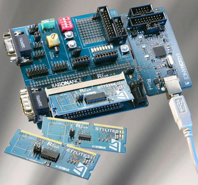

The kit offers a complete, flexible, and affordable software and hardware development solution for ST7Lite applications. It provides real-time in-circuit debugging and programming capabilities, with all the features needed to allow developers to create, build, and debug ST’s MCU-based systems. The development kit includes the REva evaluation board, the RLink USB-based in-circuit debugger/programmer, and the free RIDE-ST7 software. The RLink takes full advantage of the ST7Lite on-chip debug module, which is dedicated hardware on the micro offering powerful real-time debugging features such as hardware breakpoints on instructions, addresses, or data.
ST’s ST7Lite series is a range of entry-level 8-bit microcontrollers intended for cost-sensitive applications. ST7Lite MCUs provide outstanding flexibility at every stage of the product cycle, from the first prototype to production, ensuring reduced cost of ownership and fast time-to-market. All products in the series use the same single-voltage Flash technology and are programmed using the same techniques and tools. On-chip functions – including an accurate oscillator, a fast ADC with op-amp, and a reset circuit with low-voltage detection – simplify system design and reduce manufacturing costs.
The REva development kit is a low-cost and powerful development tool for all ST7Lite MCUs, all of which share common emulator and software development platforms. The REva board itself is an innovative, modular evaluation platform that consists of a generic motherboard with interchangeable daughterboards supporting several target ST7 microcontrollers. The daughterboards plug easily into an SO-DIMM connector on the motherboard, allowing the user to evaluate and develop applications for a range of microcontrollers from a single platform. The kit includes three daughterboards, for ST7FLITE0, ST7FLITE3, and ST72F264 microcontrollers.
The RLink in-circuit debugger/programmer supports the full range of ST7 Flash microcontrollers. It is connected to the REva for debugging and programming the MCU on the evaluation board. RLink’s USB connection is used to power the REva, eliminating the need for a power supply. The RLink also connects to the target ST7 in the application through a standard 10-pin ICC (In Circuit Communication) interface, using the ST7 ICC protocol.
