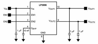

LP5996
The LP5996 is a dual output CMOS LDO voltage regulator with the same package and features as the LP3996, but does not include POR.
