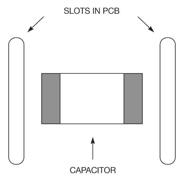

Adding a second capacitor increases cost but not as much as replacing the noisy capacitor with one that might not create noise. A ceramic capacitor from Digi-Key sells for approximately 27 cents (1000). A quieter KPS-series part from Kemet costs approximately $1.50. The second method involves making a slot in the PCB near each end of the capacitor (Figure 2). When the capacitor expands and contracts, it flexes only a small portion of the PCB, which should reduce the noise.
Reduce acoustic noise from capacitors
Figure 2. Adding a second capacitor increases cost but not as much as replacing the noisy capacitor with one that might not create noise.
A test with five 10-μF, 25V ceramic capacitors connected in parallel showed that putting three capacitors on top of the PCB and two on the bottom reduces the noise by 14 dBA (acoustic decibels). Routing a slot on both sides of the five capacitors reduces the noise by 15 dBA. Both are substantial noise reductions. A Murata JG8-series capacitor reduces the noise by 9.5 dBA. Combining these techniques should further reduce the noise.
