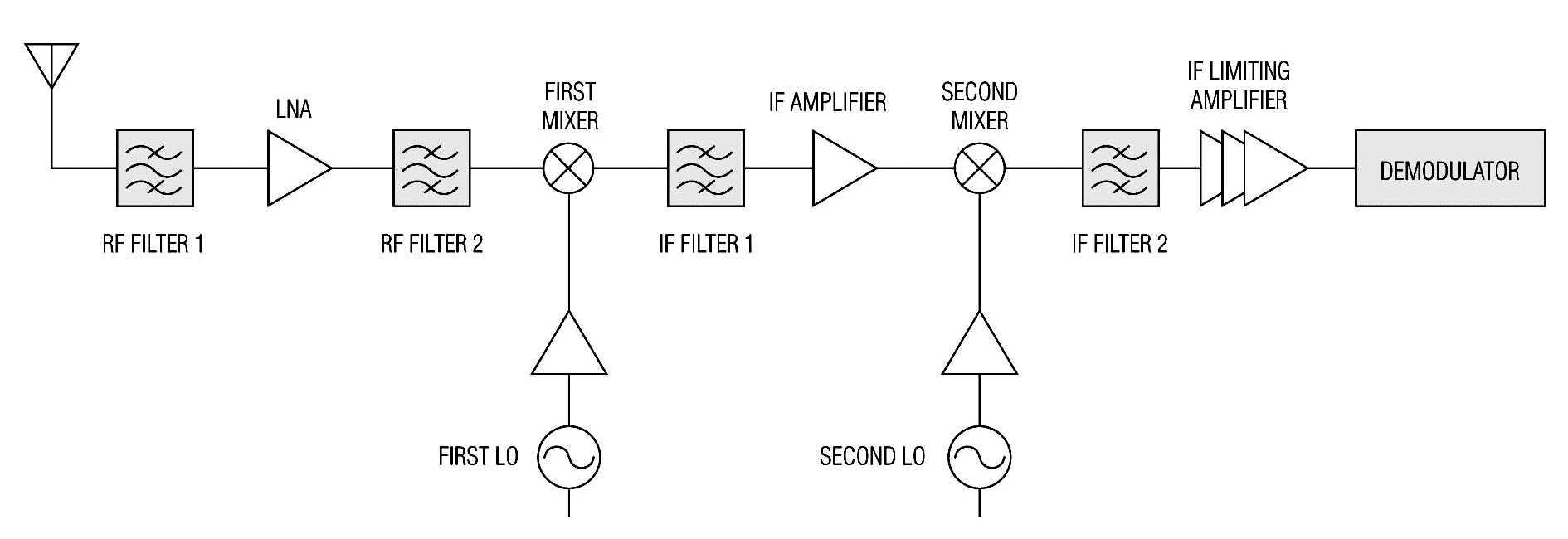

To start, we first analyze the block diagram of a typical receiver used in wireless base stations (Figure 1). These receivers are called superheterodyne receivers because the received signal undergoes two consecutive downconversions to lower frequencies. As shown, the signal is received by the antenna and then filtered by RF filter 1, which is normally used to filter out trash signals. This filter output is then amplified by an LNA (low-noise amplifier), which normally has a very low noise figure.
Block diagram of a typical wireless base-station receiver
Figure 1. Block diagram of a typical wireless base-station receiver.
The amplified signal is again filtered, this time by RF filter 2, which limits the frequency range while filtering out unwanted signals that can limit the mixer’s performance. The filtered and band-limited signal is then fed to the first mixer, where it is downconverted to an IF frequency by mixing with an LO’s (local oscillator’s) signal. Depending on the receiver’s architecture, this IF signal can be further downconverted to a second, lower-IF frequency, and then demodulated for processing in the baseband.
