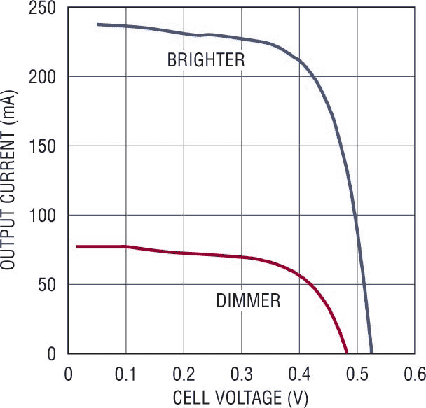

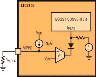

Figure 4 shows a model of the maximum power point control mechanism used by the LTC3105. Figure 3 shows the power curve for a PV cell. Note that PV cell power declines sharply from its peak as the cell voltage rises away from peak power. It is thus generally more desirable to err on the side of a lower-than-ideal control voltage, rather than a higher voltage, because the power curve rolls off more sharply on the high side.
Maximum power point control mechanism
Figure 4. Maximum power point control mechanism.
When selecting the MPPC tracking voltage, various operating conditions must be considered. Typically, the maximum power point does not move substantially with changes in illumination. As a result, it is possible to choose a single tracking voltage that provides operation near the maximum power point for a wide range of illumination levels. Even though the operating point will not be precisely at the maximum power point at extreme levels of illumination, the reduction in output power from the ideal is usually only 5%–10%.
For the power curve shown in Figure 5, an MPPC voltage of 0.4V yields performance near the maximum power point at either illumination extreme. The voltage difference from the maximum power point is approximately 20mV in both cases, resulting in a power loss of less than 3%.
Err on the side of a lower voltage when choosing a maximum power point voltage to avoid the steep drop-off

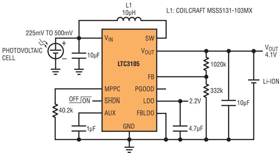

LI-ION BATTERY CHARGING IN OUTDOOR LIGHTING
One of the challenges faced by applications using a photovoltaic source is the lack of input power during darkness and low light conditions. For most applications this necessitates use of energy storage elements such as a supercapacitor or rechargeable battery that is large enough to provide power throughout the longest expected dark period.
Li-ion charging circuit
Figure 6. Li-ion charging circuit.

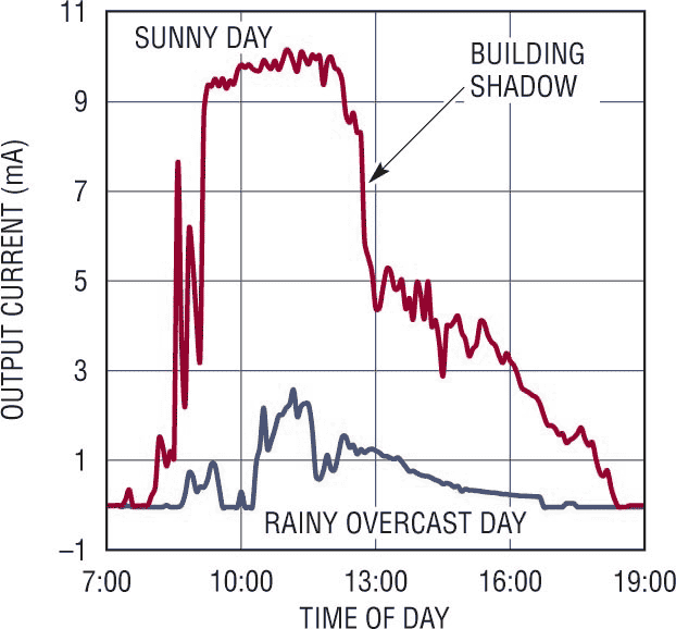

Figure 7 shows the measured charging current profile using a 2” × 1” polycrystalline PV cell to charge a Li-ion battery using the LTC3105 circuit shown in Figure 6. The upper curve of Figure 7 shows the charging current on a typical clear day with full sun. The lower curve shows the charging current observed over the course of a heavily overcast day. Even under these low light conditions a charging current of 250µA or more was maintained throughout the day totaling 6mAh of charge delivered to the battery.

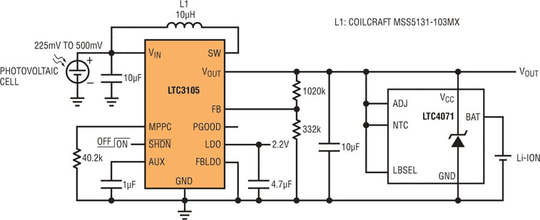

With several battery types, notably lithium and thin film, the maximum and minimum voltage must be carefully controlled. The maximum charge voltage is well controlled in LTC3105 applications since the converter terminates charging when the output comes into regulation. To prevent over-discharge, the LTC3105 can be used in conjunction with the LTC4071 shunt battery charger as shown in Figure 8.

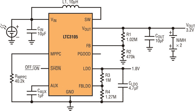

Single-cell photovoltaic NiMH trickle charger
Figure 9. Single-cell photovoltaic NiMH trickle charger.

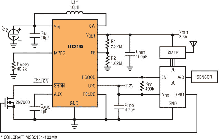

Single-cell-powered remote wireless sensor
Figure 10. Single-cell-powered remote wireless sensor.
