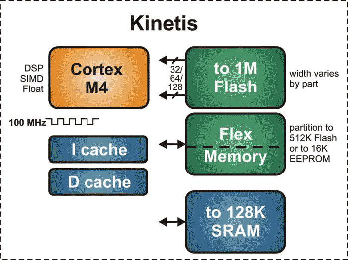

Freescale Semiconductor Kinetis – Flexible memory
Freescale Semiconductor's primary microcontrollers based on ARM processors took a while to get started, although it has sold 32-bit MCUs based on the Power Architecture and its proprietary ColdFire architecture for decades. Jumping quickly on the ARM Cortex-M4 core with its enhanced capabilities, Freescale filled out its new Kinetis product families fairly well (see Figure 3).
Freescale Kinetis architecture
Figure 2. Freescale Kinetis architecture (Courtesy Freescale).
Ranging from the smallish K10 to today's full-bore K70, on-chip Flash is available from 32 KB to 1 MB, organized from 32 bits to 128 bits wide depending on the chip. Manufactured on a 90 nm process node, the Flash responds in around 30 ns depending on voltage, but the Kinetis MCUs run up to 100 MHz with promises of double the speed. Freescale's thin film storage (TFS) Flash can read, erase, and write at voltages down to 1.71 volts, which is nice because it is within the limits of two almost-spent 1.5 volt AA batteries (which degrade rapidly once they hit 0.9 volts each).
Kinetis MCUs have their own instruction and data caches to help overcome Flash read delays, and they address off-chip memory as well. This is effective enough that Kinetis MCUs look as efficient as the others up to Kinetis' rated speed. A memory protection unit helps the operating system keep one task's program from getting into another task's memory space.
The primary Flash is supplemented with something Freescale calls FlexMemory, a special variety of Flash that can also operate as E2PROM. The programmer decides how much to use as program Flash with the balance being used as E2 – up to 16 KB. The portion that operates as E2 automatically engages special logic that performs wear-leveling and writing algorithms to get one million and possibly up to 10 million endurance cycles as more FlexFlash is dedicated.
As is the case with some other vendors, Freescale utilizes a crossbar switch to let the main Flash, the FlexFlash, the SRAM, and various peripherals be accessed simultaneously by bus masters in order to keep data moving optimally.

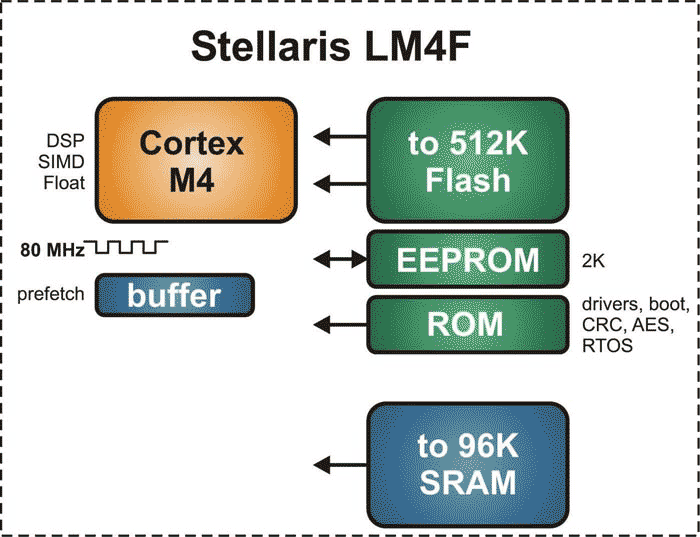

Texas Instruments Stellaris – Firmware included
The Stellaris microcontrollers were the first products to use the new ARM Cortex-M3 architecture when they were developed by lead partner Luminary Micro, now owned by Texas Instruments. Stellaris has a rich collection of MCUs serving applications from motor control to networking and user interfaces.
The Texas Instruments MCUs run at modest 80 MHz speeds, have up to 512 KB of error-checking Flash memory, up to 96 KB of data RAM, and some have their own 2 KB of traditional E2PROM on-chip. Stellaris' Flash memory can perform single-cycle reads up to 50 MHz, above which the effect of a prefetch buffer minimizes delays by fetching 64-bits per read and engaging speculative branching.
While ROM seems to have disappeared on most MCUs these days, many Stellaris LM3S and Cortex-M4-based LM4F MCUs (see Figure 4) make a special use of compact ROM to store some fundamental and often-accessed code that is likely to be used by all applications. These drivers and routines are called StellarisWare and consist of peripheral driver libraries, boot loaders and vector tables, the pre-emptive real-time scheduler SafeRTOS, cyclic redundancy check (CRC) error detection operations, and cryptography tables used for the Advanced Encryption Standard (AES) functions. Putting these useful functions and data in fast, cheap ROM (where appropriate) frees up a significant quantity of Flash that is better used for custom code that enhances the end equipment.
Texas Instruments Stellaris LM4F architecture
Figure 4. Texas Instruments Stellaris LM4F architecture (Courtesy Texas Instruments).
