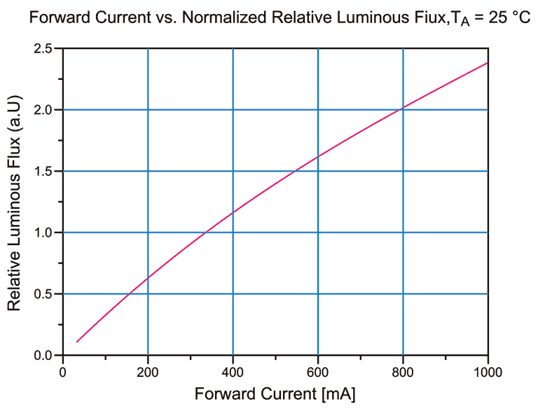

For three of the parts, this means applying the ‘flux normalisation’ graph found in each datasheet (see Figure 1 for a typical example). The graph will provide a factor to use for each specific LED to calculate the light output produced at the higher current.
Example of Flux normalization graph
Figure 1. Example of Flux normalization graph.
As we now see in Table 2, the MFR 3 emitter is no longer the leader in light output, but the comparisons here are still some way from being like-for-like, since we are not yet comparing the LEDs’ performance in actual operating temperatures.
