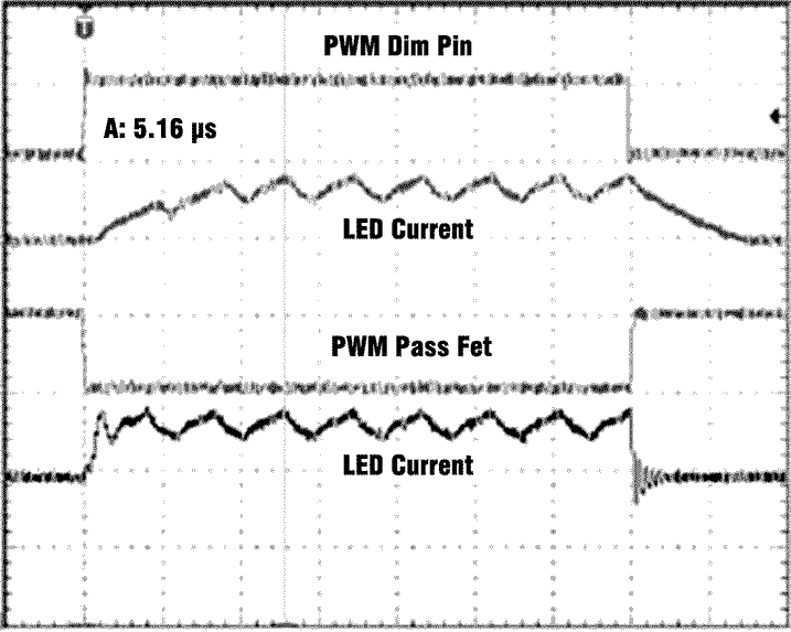

Fast PWM Dimming with a Shunt Device
Because of the delays in shutdown and start up of the converter’s output, there is a limit to the PWM dimming frequency and range of duty cycles. To help overcome this delay, an external shunt device such as the FET shown in Figure 4 can be placed parallel to the LED or LED string to quickly bypass the converter’s output current around the LED(s).
The current in the inductor stays continuous during the “LED shutdown time,” avoiding the long delay in ramping up and down the inductor current pedestal. The delay time now shifts to the limits of the shunt device’s rise and fall times. Figure 4 shows the LM3406 fitted with a shunt FET and a plot comparing the LED on/ off delays between using the DIM function pin vs. the shunt FET. The output capacitance used in both of these measurements is 10 nF and the shunt FET is a Si3458.
Fast PWM Dimming
a)
Fast PWM Dimming
b)
Figure 4. Fast PWM Dimming. Circuit (a) and PWM Waveforms (b).
Caution should be used with shunting the LED current with current-mode converters because of the overshoot in output current when the FET turns on. The LM340x family of LED drivers are controlled on-time converters and will not exhibit this overshoot. Output capacitance across the LEDs should be kept low to maximize on/off / on transition speed.
A disadvantage to the fast-dim circuit vs. shuttingdown the outputs is loss of efficiency. While the shunt device is on, a power dissipation of VSHUNT DEVICE × ILED is lost as heat. Use of low RDS-ON FETs will minimize this loss of efficiency.
