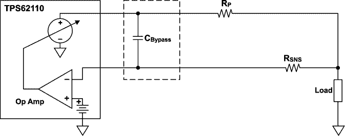

If there is no dedicated differential amplifier, the power supply can still be remotely sensed. A remote sense resistor can connect the load voltage back to the converter, compare the load voltage to the reference voltage, and regulate the output voltage. Figure 2 shows the TI TPS62110 step-down converter configured to remotely sense the load and regulate the output for any parasitic-resistance (RP) voltage drop.
Remote sensing for power supplies
Figure 2. Remote sensing via resistor RSNS regulates the output for RP voltage drop.
However, when a dynamic load is applied as illustrated in Figure 2, the remote sense line picks up the dynamic voltage and tries to compensate for the voltage drop across the parasitic resistance (RP). This may result in a low-frequency oscillation due to the controller propagation delay. It appears as slight jittering on the switching waveform and causes elevated ripple on the output side. A high-frequency bypass capacitor (CBypass) can easily remedy the situation. It filters out the high-frequency dynamic voltage while keeping the characteristics of DC remote sensing.

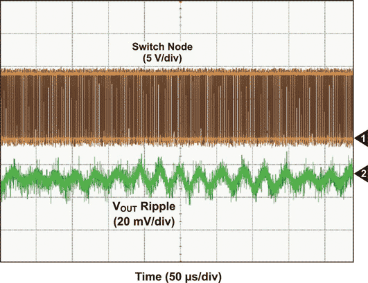

Figure 3. Original output ripple with 33-kHz oscillation.

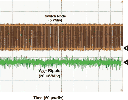

A 7-V gate-drive power supply with a 1-µF bypass capacitor was tested with the TPS62110 step-down converter. Figure 3 shows an output ripple with 33-kHz oscillation that occurred when no bypass capacitor was used. Figure 4 shows that the addition of a 1-µF bypass capacitor clearly removed the 33-kHz oscillation from the output voltage and resulted in a low output ripple of 20 mV, which was 0.3% of the regulated voltage.
Figure 4. Low output ripple with oscillation removed by 1-µF bypass capacitor.
