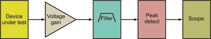

Oscilloscopes often are used to measure power supply, linear regulator, and reference noise. Since an oscilloscope has a sensitivity in the range of 2 mV per division, a substantial voltage gain must be added to see the ripple and noise, which is often in microvolts. This gain is usually accomplished using a “low-noise” operational amplifier or several cascaded low-noise op amps. An active filter follows the op amps, providing high pass and low pass elements, to meet the desired measurement bandwidth with the entire circuit constructed in a Faraday shield. (A paint can serves this purpose.) Several IC manufacturers have application notes describing the measurement (Fig. 1).
Use A Signal Analyzer To Measure Power Supply, Regulator, and Reference Noise
Figure 1. The typical measurement setup for testing noise using an oscilloscope requires a very high-gain LNA, active filter, and peak detector, making it one of the more difficult measurements. It also provides less information than other methods, since no frequency relationship is provided from this measurement.
Several limitations are evident in this setup. First, building such a configuration takes time, effort, and extreme care. Next, the high gain required often limits the bandwidth of the measurement, and the amplifiers provide a noise path through the power supply rejection ratio (PSRR), making the circuit sensitive to the power supplies that power the circuit. In addition, the amplifier itself contributes noise.

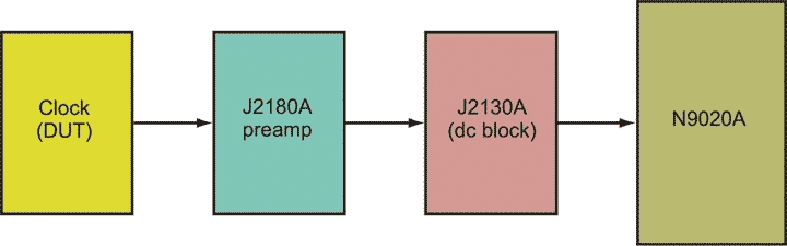

There are two basic methods for measuring voltage regulator/reference noise. One method is to measure the phase noise of a high-performance clock, which is powered by the regulator under test. A phase noise measurement of a crystal oscillator offers an effective indirect measurement of regulator noise. The noise signals from the regulator appear as amplitude modulation and as mixing products in the oscillator frequency. The phase noise measurement identifies specific noise frequencies, which can be seen as “spurs.”

The second noise measurement method calls for directly measuring the device under test (DUT) (Fig. 3). To demonstrate the validity and the sensitivity of its noise measurement, the noise floor of a typical measurement setup was recorded. The noise floor is measured as a direct measurement, including the Picotest J2130A dc bias injector used as a dc blocker and the J2180A preamp. The J2180A improves the noise floor by nearly 20 dB, while also presenting a high-impedance connection to the DUT (Fig. 4). This is important since the 50-Ω termination could easily impact the noise result.

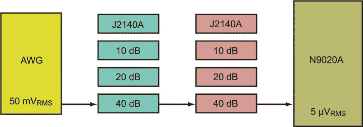

Figure 5. Validating the N9020A noise measurement using the J2140A attenuators solely verifies that the measurement amplitude is correct by measuring a very small known signal. The J2140A attenuators reduce the signal level to a very low level (5 µVRMS).
Next, an arbitrary waveform generator (AWG) is set to provide a 1-kHz, 50-mVRMS sine output. A pair of Picotest J2140A cascadable attenuators, each configured for an attenuation of 40 dB, is connected between the AWG and the N9020A (Fig. 5). The attenuator greatly reduces the generator signal level to verify the sensitivity of the measurement. The resulting signal, as measured on the analyzer, displays 4.56 µV average (5.06 µVRMS), which is correct (Fig. 6).
Figure 6. Designers can perform signal verification using the J2180A preamp with a 1X scope probe and a 20-dB gain correction factor to account for the 20-dB preamp gain. The measured 4.6-µV average signal is 40 dB above the noise floor of 46 nV and in excellent agreement with the 5-µVRMS signal level injected. The average to RMS conversion is 1.1, so 4.6 µV average × 1.1 =5.06 µVRMS.
Having shown that the noise floor of the measurement is approximately 45 nV and verified that the setup correctly and accurately measured a 4.6-µV average signal, we can now use this setup to directly measure voltage regulator and reference noise.
