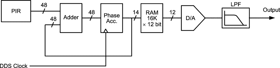

Many of the concepts of DDS are illustrated by the way in which a sine wave is generated. The figure below shows a block diagram of a simple DDS function generator. The sine function is stored in a RAM table. The RAM's digital sine output is converted to an analog sine wave by a DAC. The steps seen at the DAC output are filtered by a low pass filter to provide a clean sine wave output.
Simple DDS Function Generator.
The frequency of the sine wave depends on the rate at which addresses to the RAM table are changed. Addresses are generated by adding a constant, stored in the phase increment register (PIR), to the phase accumulator. Usually, the rate of additions is constant, and the frequency is changed by changing the number in the PIR.
The frequency resolution depends on the number of bits in the PIR. If the PIR, adder, and phase accumulator support 48-bit additions, then the fractional frequency resolution is one part in 247, or about 1×1014. That means a 48-bit DDS generator can provide better than 1 µHz resolution on a 10 MHz output. There are a few more details which need to be addressed in order to understand DDS in this application. Questions about sample rate, RAM size, DAC resolution, filter characteristics, and spectral purity of the output must be answered.

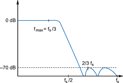

The graph below shows a low pass filter transfer function. As we have seen, the filter must pass the highest frequency which we wish to generate (fmax), but must begin its stop-band at fs–fmax. Steep rolloff filters with high stop-band attenuation are hard to build. A reasonable compromise in this trade-off occurs when fmax=fs/3. This allows the filter a one octave transition band.
Low pass filter for DDS outputs
Low pass filter for DDS outputs.
What stopband attenuation is needed? This depends on the spurious component specification of the output. A typical specification for a function generator application would be –70 dBc.
Cauer (elliptic) filters are a good choice for this application. They have fast transition bands and may be designed with very low ripple in the pass band. The specification for this example is met by a ninth degree Cauer filter.

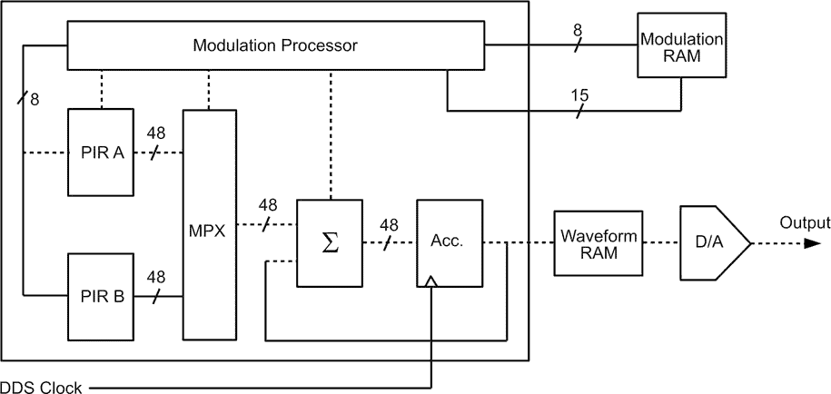

The power and elegance of DDS are most apparent when a modulated source is required. The frequency of the output may be changed instantly to any frequency from DC to fmax by simply changing the number in the phase increment register. Figure 4 shows the block diagram of a DDS phase accumulator with programmable modulation capabilities.
DDS phase accumulator with modulation processor
Figure 4. DDS phase accumulator with modulation processor.
This phase accumulator, which has been optimized for function generator applications, has two phase increment registers: PIRA and PIRB. A 48-bit wide multiplexer can switch between the PIRs in a single clock cycle. The modulation processor can modify the PIRs at a rate of up to 10 million bytes per second, filling one PIR while the other is used as an input to the adder.
Complex modulation programs may be stored in the modulation RAM. This RAM contains op-codes and data for operation of this processor. When programmed for a log frequency sweep, a list of up to 4000 discrete frequencies are stored in the modulation RAM by the host system. The modulation processor modifies PIRA while the adder is using PIRB and vice-versa.
More complex modulation programs may be stored, such as frequency modulation by any arbitrary function, linear or log sweeps, frequency hopping (Figure 5), etc. Phase modulation is easily done by programming PIRA with the nominal frequency, and using PIRB, which contains the nominal phase increment plus any desired phase shift, for a single clock cycle.
