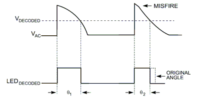

When dimming an LED fixture, the TRIAC may misfire—that is, conduct insufficient current to remain on for the whole conduction angle. Because the misfires are usually asymmetrical in consecutive rectified ac-line cycles, the decoded angle can oscillate between two or more points. This oscillation manifests itself as visible flutter and flicker of the light output because of the low frequency. To prevent visible flicker, the converter must burn extra power to ensure that the TRIAC does not misfire.

  Figure 2. Most LED systems employ some form of PFC, which forces the voltage and current to stay mostly in phase. As a result, the phase dimmer usually misfires toward the end of the conduction angle where the voltage and current are decreasing and creates a varying angle decode, depending on where the misfire occurs.
New regulations for power quality now require PFC (power-factor control) for many LED systems. PF (power factor) is a measure of how well energy transfers from the input to the output of a converter. If the input current is free of distortion and perfectly in phase with the input voltage, the PF is one. Any phase shift or distortion of the input current due to reactive elements and switching noise decreases the PF.
Because most LED systems employ some form of PFC, the input current usually fairly well follows the input voltage, meaning that the phase dimmer usually misfires toward the end of the conduction angle where the voltage and current are decreasing (Figure 2). This misfire creates a varying angle decode, depending on where the misfire occurs.

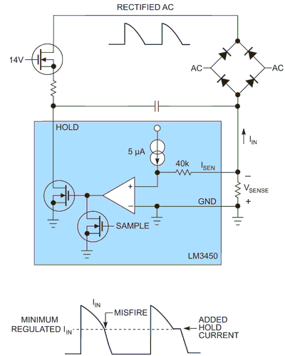

For example, in an 85 to 305 V-ac universal input 15 W LED downlight, the worst-case hold-current condition occurs at 305 V ac, when the input current is at a minimum. To ensure that the TRIAC remains on over the entire conduction angle at 305 V ac, you must add a fairly large amount of hold current. Because it is a universal design, the hold current you add at 85 V ac would be approximately four times larger than necessary—a large waste of power.
Dynamic hold
The best way to maximize efficiency is to regulate the minimum input current. This approach draws no extra hold current when the input current is above the regulation point. Below the regulation point, the circuit draws enough current to maintain the minimum hold requirement. The LM3450  controller implements this method, called dynamic hold (Figure 3). A sense resistor between the diode-bridge return and system ground provides a method for input-current sensing. Using the sensed voltage across that resistor, the controller linearly draws current through the hold pin to maintain the minimum regulated input current. This ensures that any extra power dissipation is minimized.
Ultimately, the dynamic hold is necessary to ensure that the phase angle is being properly decoded to provide an accurate dimming command to the converter. The idea is to keep the TRIAC from misfiring during decoding so that the angle does not sporadically change, causing flickering. Looking closer at the system, it is actually unnecessary to decode the angle every cycle. A sampled system could provide even more efficiency relief. In this approach, the extra holding current would need to be added only during the sampling interval when decoding is taking place. During the non-sampled cycles, no current would be needed.

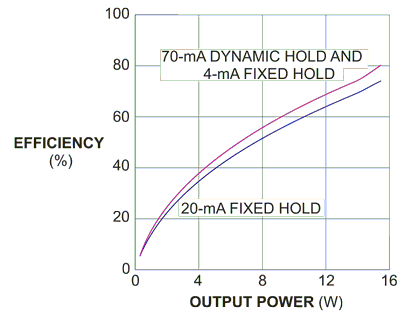

The LM3450 employs this sampled-phase-decoder scheme, and the dynamic hold is thus active only during the sampling interval. To validate this approach, a 120 V, 15 W downlight application is implemented with both a fixed 20-mA holding current and a much larger 70-mA dynamic holding current (Figure 4). The 70-mA dynamic hold ensures a complete dimming range with more than 20 tested dimmers and yields an efficiency improvement of as much as 6%.

Figure 4. The results for a 120 V, 15 W downlight application using both a fixed 20-mA input load and a 70-mA dynamic hold show that the 70-mA hold ensures complete dimming range with more than 20 dimmers and yields an efficiency improvement of as much as 6%.
