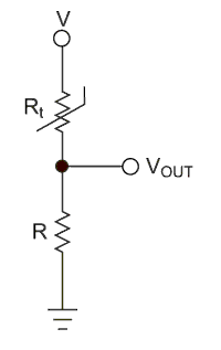

For accuracy up to ±0.1°C, with the tradeoff of an even smaller temperature range (less than 100°C), thermistors can be used. Similar to RTDs, thermistors’ resistance also change with temperature. Thermistors typically are connected in a resistor divider configuration where the other resistor in the divider is the same as the nominal value (value at room temperature, 25°C) of the thermistor. One end of the thermistor is connected to the supply voltage and the other end is connected to the other resistor, which in-turn is connected to ground (Figure 1). To determine temperature, measure the voltage at the divider’s center point. You would expect +V/2 at 25°C. Any deviations from this you can calculate the thermistor’s resistance and use a look-up table to determine the ambient temperature being measured.
 What makes industrial sensors go awry?
Figure 1.  A thermistor circuit is shown with one end connected to the supply voltage and the other to the other resistor and the ground.

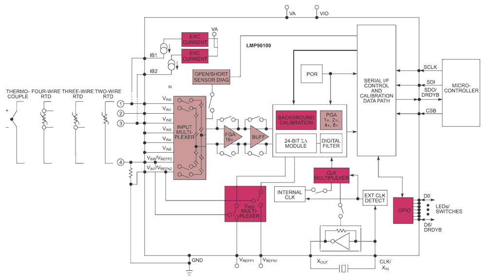

In summary, temperature sensors need bias (voltage or current). When it comes to thermocouples, cold junction compensation is needed. TI offers a complete solution to these requirements. The LMP90100 is a 24-bit sensor AFE system with four differential or seven single-ended inputs, with two matched programmable current sources, and continuous background calibration (Figure 2). The LMP90100 is an integrated configurable chip perfect for addressing the various design challenges associated with temperature sensors.
Figure 2.  The LMP90100 24- bit configurable sensor AFE addresses a variety of design challenges inherent with temperature sensors.

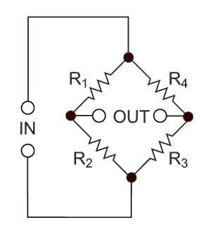

Strain-gauges and load cells that utilize the Wheatstone bridge circuit are popular implementations for measuring pressure, force, and weight. Any strain or stress on the gauge causes a resistance change and subsequent voltage differential change on the sensor output (Figure 3). The voltages that come out of these sensors are low, typically in the mV range. To make the most accurate measurements, amplify this small voltage up to the data converter’s full dynamic range. To allow interfacing with multiple sensors as well as optimum flexibility, use a programmable gain amplifier (PGA) stage. This stage should have low noise, low offset, and low-offset drift to ensure best system performance.
Figure 3.  A Wheatstone-bridge circuit is shown. Any strain or stress on the gauge causes a resistance change and subsequent voltage differential change on the sensor output.
These types of sensors also require excitation in the form of a bias voltage. A common failure mode for pressure sensors is incorrect measurements due to opens or shorts in the bridge. Even harder to detect are out-of-range signals caused by sensor damage or degradation over time. A way to catch all of these failure modes is by incorporating a diagnostic circuit. This circuit injects a small current, sometimes referred to as “burnout” current, into the resistor ladder of the Wheatstone bridge and then measures the resulting voltages produced. For example, if the bridge outputs are at the same potential (V+/2), is it because there is no pressure on the gauge? Or because you have a failure in the system that is shorting the outputs? This can be answered by injecting current into one of the differential outputs and measuring the differential voltage between the outputs. In normal operation the differential voltage will be the voltage drop across the resistors in the bridge. However, if there is indeed a short there will be little or no voltage drop.
In short, Wheatstone bridge sensors require an excitation voltage, low noise/offset PGA, and diagnostics. The LMP90100 also mates well with these types of sensors. Its continuous background sensor diagnostics allow detection of open circuit, short circuit, and out-of-range signals. By injecting burnout currents into a channel after it has undergone a conversion, it avoids burnout current injection from interfering with the channel’s conversion result. Diagnostics provide continuous noninvasive failure detection, aid in root cause analysis, and minimize system down time.

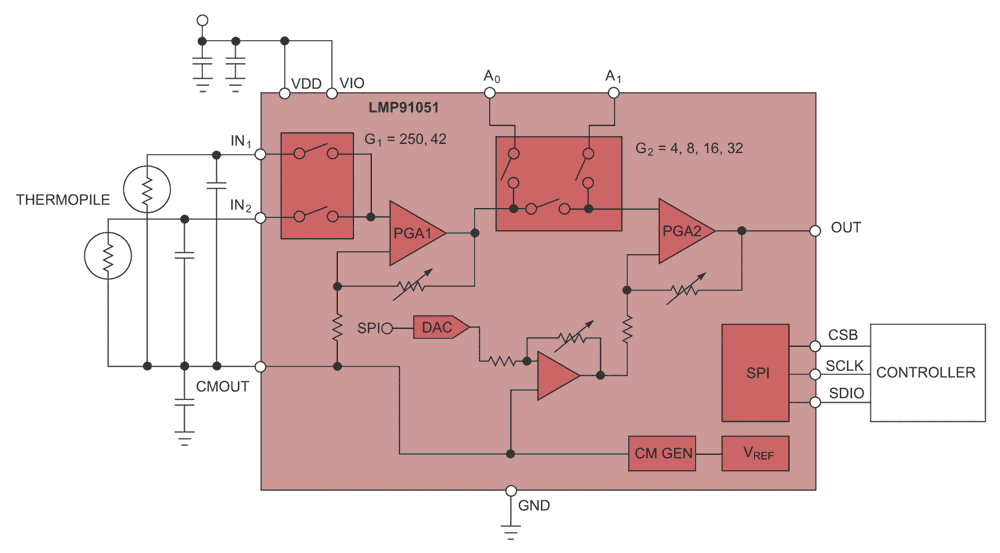

Again, NDIR systems need a reference channel, adjustable amplification, offset compensation, and biasing. This all can be handled by the LMP91051, configurable sensor AFE for NDIR sensing applications (Figure 4). It has a dual-channel input to support an active and reference channel, a PGA, adjustable offset cancellation DAC, and common-mode generator. The LMP91051’s ability to integrate these important NDIR system blocks reduces design time, board space, power, and cost.
Figure 4.  The level of integration provided by the LMP91051 configurable sensor AFE for NDIR sensing reduces design time, board space,
power, and cost.

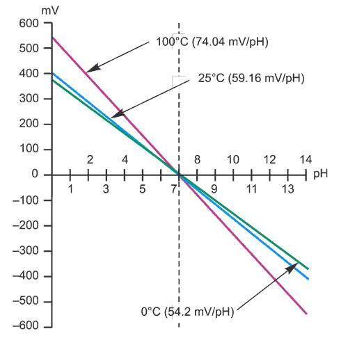

Figure 5.  A pH electrode produces a voltage output that is linearly dependent upon the solution’s pH being measured.

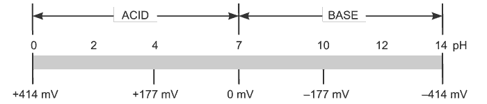

The pH electrode produces a voltage output that is linearly dependent upon the solution’s pH being measured. The transfer function and pH scale in Figures 5 and 6 show that as the solution’s pH increases, the voltage produced by the pH-measuring electrode decreases. Note that a pH electrode’s sensitivity varies over temperature. Looking at the pH electrode transfer function shows that the sensitivity linearly increases with temperature. Due to this behavior, it is critical to know the solution’s temperature being measured and compensate the measurement accordingly.
Figure 6.  As the pH increases, the voltage produced by the pH-measuring

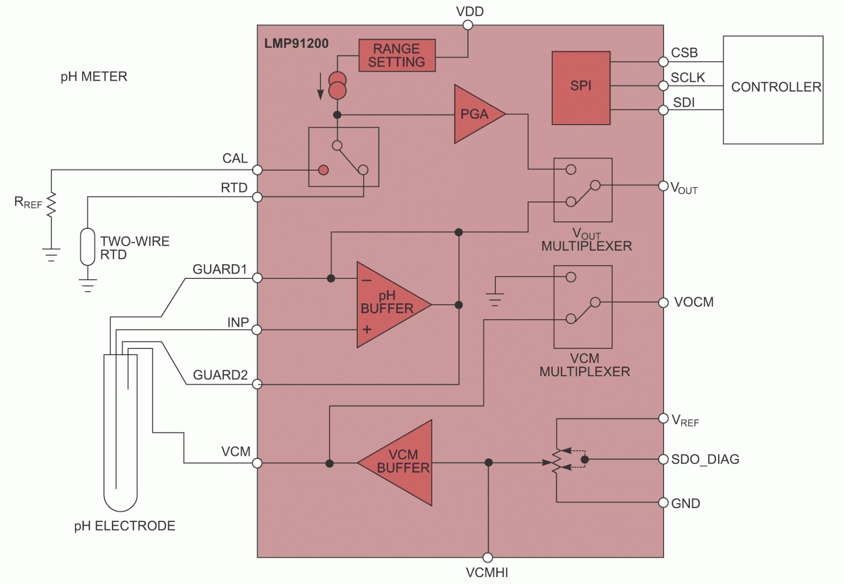

In the end, pH sensors require a high-impedance, low-input bias current interface, common-mode voltage, and temperature compensation ability. The LMP91200 sensor AFE for chemical sensing addresses these functions (Figure 7). You can interface easily with RTDs with its programmable current source. Temperature measurement accuracy is further enhanced with the multi-step temperature measurement feature, which removes error in the temperature signal path. The device’s input bias current is in the range of only tens of fA at 25°C, minimizing error when connecting to a high-impedance pH electrode. Finally, the bias current is just hundreds of fA when the device is powered off, minimizing electrode degradation due to current draw over time.
Figure 7.  The LMP91200 configurable sensor AFE for chemical sensing addresses the need for high impedance, a low-input bias current interface, common-mode voltage, and temperature compensation.
