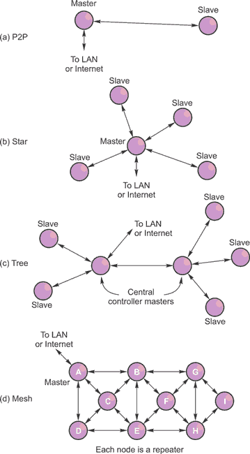

There are multiple ways to implement a wireless network, depending on the application (Fig. 1). A wireless node (each circle in the figure) may be a transmitter (TX), receiver (RX), or transceiver (TX/RX). Some nodes are just slaves to be monitored or controlled. Others become managers or data aggregators for connections to external communications. Some nodes may also serve as repeaters to relay data from one node to another.
What's The Difference Between Bluetooth Low Energy And ANT?
Figure 1. The most common topologies for wireless networks are point-to-point (a), star (b), tree (c), and mesh (d). Each node is a transceiver, and each network has a master controller.
The point-to-point (P2P) link is the simplest form (Fig. 1a). It could be a single transmitter to receiver link, or both nodes could be transceivers. A transmit node would be a sensor. A node connected to an actuator device would be a receiver.
Another common topology is the star configuration (Fig. 1b). Multiple nodes connect to a central collection or control node. Thus, it’s called a multipoint-to-point (M2P) connection. The nodes don’t talk to one another, just to the central collection point. A star network could work the other way in which the central node broadcasts to all other nodes, though, making it a point-to-multipoint (P2M) link.
A tree network can have many branches (Fig. 1c). This one shows a star network talking to another star network through their central controllers. Another popular configuration for sensor networks, mesh, can be configured into a number of variations (Fig. 1d). The key characteristic is that all nearby nodes can talk to one another.
Furthermore, all or most nodes can be repeaters, whereby data may be passed from one to another that’s not directly connected. For example, node F can’t connect directly to node A because of distance or power limitations, but it can pass the information through other nodes (e.g., B or E and C). This mesh feature makes it possible to extend the network over a very wide range that’s beyond the normal reach of most nodes.
In addition, a mesh network offers great reliability. If one node goes down because of battery or other failure, or a node is temporarily blocked in some way, alternate paths are found through the network to transmit the data. Mesh networks tend to be more complex, but the range and reliability they provide may be worth the added expense.
All of these networks have a central control or collection node. It could be a laptop computer, a cell phone, or some special router device that connects to a local-area network (LAN) or the Internet. This master control point stores and forwards the information to the appropriate destination.

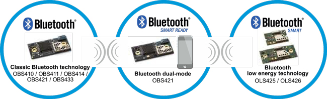

One key point must be taken into consideration, though: BLE is incompatible with standard Bluetooth. BLE devices don’t interoperate with classical Bluetooth products. However, implementing a dual-mode device could achieve such interoperability if so desired.
A dual-mode device is an integrated circuit that includes both a standard Bluetooth radio and a BLE radio. Each operates separately but not at the same time, though they can share an antenna. Several vendors offer dual-mode chips, such as Broadcom, CSR, EM Microelectronics, Nordic Semiconductor, and Texas Instruments. Complete modules also are available from connectBlue (Fig. 2).
Complete Bluetooth modules developed by connectBlue include a classic Bluetooth module
Figure 2. Complete Bluetooth modules developed by connectBlue include a classic Bluetooth module, a Bluetooth Smart Ready module that supports both standard Bluetooth and BLE, and a Bluetooth Smart module that includes only BLE.
