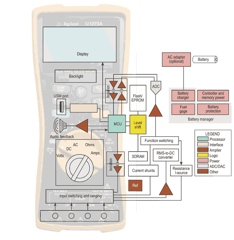

The heart of any HHDMM is its analog-to-digital converter (ADC). The ADCs used in the first HHDMMs back in 1970s are still in use today some 40 years later. Many hobbyist HHDMMs still employ the Intersil ICL7106 because it is inexpensive, simple to use, and easy to design into a circuit. The 7106 has a single dual-slope converter with a 2,000-count display, updated at a leisurely pace of two readings/sec. Few electronic devices have such a vintage.
Modern advanced HHDMMs use ADCs that are much faster than the Intersil part and which handle multiple tasks. Modern devices are typically 24-bit devices that use a delta-sigma conversion scheme, chosen because it is inexpensive realize with modern ICs. These 24-bit devices allow displays of dual 30,000-count readouts updated at a rate of seven readings/sec as well as an analog bar graph running at 50 readings/sec.
Accompanying the higher-resolution displays are more precise voltage references and input-divider precision resistor networks. These works together to deliver higher meter accuracy specifications. They are also fast enough to power additional meter features such as a frequency counter, true RMS ac converter, auto-ranging, and a temperature reference.
A hobbyist meter using a 7106 has little use for a beefy MCU. But modern meters carry a controller powerful enough to handle a lot of raw measurement data. The more-powerful controller makes it possible for modern meters to run fairly sophisticated measurement tasks that are just not possible with less-expensive meters. These tasks can include such functions as an automatic offset of stray DC voltage due to leakage current or thermal EMF, measurements of harmonic ratio, selectable dBV or dBm readings with a reference resistance, selectable scaling factors for reading transducers, selectable K or J thermocouple measurements scaled in °C or °F, event-triggered logging using auto hold, trig hold or peak hold, and many more.

Handheld digital multimeters made today all tend to have block diagrams that are similar. But some of the most important meter features concern ergonomics and safety. These don’t show up in block diagrams.
