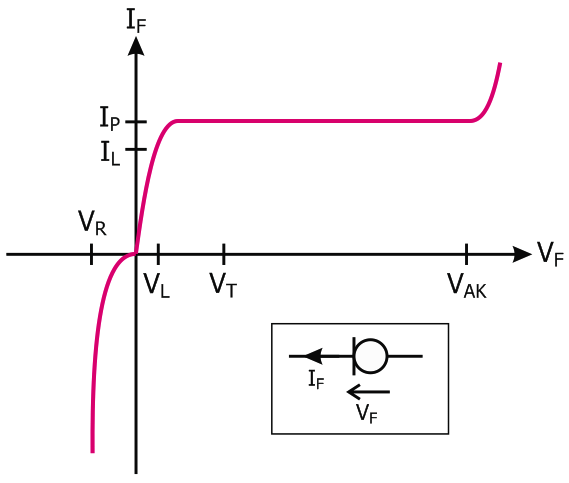

Like a Zener diode keeps a voltage constant over a wide range of Zener current, the Current Limiting Diode or CLD keeps a current constant over a wide range of forward voltage. Figure 1 shows the typical IF vs VF curve of such CLD device, including the symbol and current/voltage definitions. When applying a positive voltage from anode to the cathode (indicated by cathode mark), the current rises until it reaches a constant value IP. The start of this current limiting area is defined by the limiting voltage VL, above which IL = 80% of IP is reached. IP remains constant, unless a maximum admissible voltage VAK is reached, above which a breakdown happens and the device can be destroyed. In reverse direction, the voltage VR is quite quickly reached. So operating voltage range is between VL and VAK, where current is kept to a constant value IP; the reverse direction is normally not used.

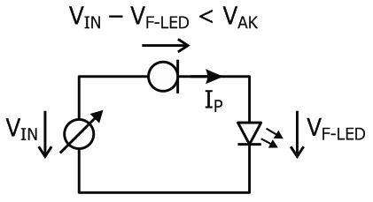

Taking the function of the CLD into account, such device can be used to drive LEDs with a constant current IP from a variable voltage source VIN, see Figure 2. The only condition is to limit the voltage across the CLD to a value less than VAK; that voltage is the difference between VIN and the voltage drop at the LED, VF-LED.

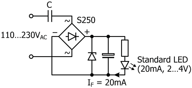

Figure 3 shows how up to now LEDs are driven at AC mains. The Zener diode, electrolytic capacitor and power resistor is required to keep the forward current IF through the LED constant. The electrolytic capacitor has got the shortest lifetime of all components in the circuit and is the limiting element. During turn-on, a current peak can occur at the bridge, caused during initial charge of the AC and electrolytic capacitor. Therefore here the S250 by Diotec is used, featuring a very high forward surge rating of 40 A (at 50 Hz).

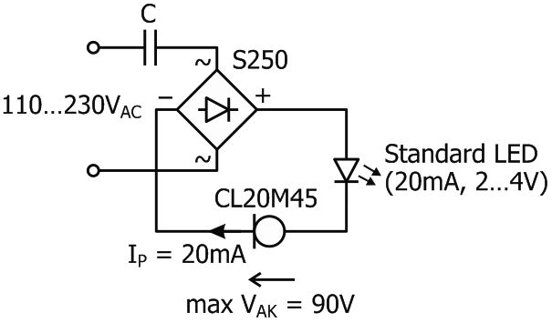

The circuit on Figure 4 simply needs 3 components to drive one (or more) Standard LEDs at a wide input range. The AC capacitor C has got a certain dynamic impedance
Depending on the output power (and related to that, the input or mains current), there is a voltage drop across this impedance. C has to be chosen such way that the voltage drop is big enough to ensure that VAK of the CLD is not exceeded.

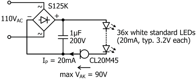

Here (Figure 5) not only one, but an array of Standard LEDs is used. The resulting voltage drop across the series of LEDs is big enough to ensure VAK is not exceeded. Thus, by only one rectifier bridge and one single CLD a complete LED luminaire, operated at 110 VAC, can be done. The here used Protectifiers® bridge S125K has the advantage of an increased ESD capability, and provides as such additional protection for the LED array.

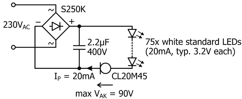

only 3 components for driving LED arrays at 230 VAC 2)
Here (Figure 6) the same circuit, but operated at 230 VAC mains. Due to the higher peak voltage, more LEDs have to be connected in series. Anyway, a single rectifier bridge is enough to complete the whole circuit! The here used Protectifiers® bridge S250K has the advantage of an increased ESD capability, and provides as such additional protection for the LED array.
Cost Effective Driving of Standard LEDs from 10VDC up to 110/230VAC with Current Limiting Diodes - Flicker Free!
Figure 6.
An additional mains fuse is recommended to provide circuit protection in case of any unforeseen shorts 2).
