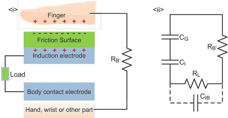

The energy harvesting mechanism and equivalent circuit of the STEG with
the human body as an electrode. When a finger taps the friction surface,
it has a tendency to donate electrons, causing an electric charge to move
back and forth between the induction electrode and the charged skin.
Credit: Meng, et al. ©2014 AIP Publishing LLC

In their study, the researchers covered the front panel of a mobile phone with a flexible, transparent layer of STEG composite material. The body contact electrode – contacted with the palm of the hand or the fingers – was located on either the back side or the border of the phone to complete the electric connection.The researchers demonstrated that patting the phone with the palm of the hand or tapping the phone with a finger causes electrons to be exchanged between human skin and the STEG material. After repeated patting/tapping, electric charge moves back and forth between the induction electrode and the charged skin.
Although researchers have a good understanding of how the triboelectric effect works, the difficulty lies in designing a generator that can achieve good performance. Somewhat surprisingly, when the researchers replaced the grounded electrode in the STEG with a human body electrode, the STEG achieved an increase in both the output current and the amount of charge transferred.
