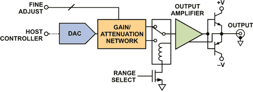

In the past, the most difficult part of an arbitrary waveform generator was designing the output stage. Typical signal generators offer output ranges from 25 mV to 5 V. To drive a 50-Ω load, traditional designs used high-performance discrete devices, a large number of integrated devices in parallel, or an expensive ASIC, with designers spending countless hours to create a stable, high-performance output stage with a wide programmable range (Figure 1). Now, advancements in technology have produced amplifiers that can drive these loads, reducing output stage complexity while decreasing cost and time to market.

Figure 1. A typical signal generator model.
When using general-purpose signal generators, a frequency is entered, a button is pressed, and the instrument produces a new frequency. Next, the desired output power is entered, and another button is pressed. Relays click as they switch internal networks to adjust the output level. This discontinuous operation is required to compensate for the lack of a wide programmable range. This article proposes a new architecture that also solves this half of the problem with the output stage design.

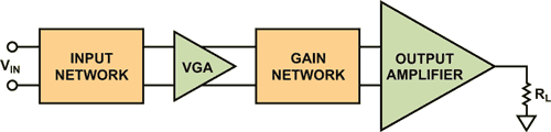

Figure 2. The smaller, simpler, signal generator output stage.
The two key components that solve this front-end design challenge are: a high-performance output stage that provides high speed, high voltage, and high output current; and a variable-gain amplifier (VGA) with continuous linear-in-dB tuning. This design targets 20-MHz performance, with 22.4-V amplitude (+39 dBm) into a 50-Ω load (Figure 1).

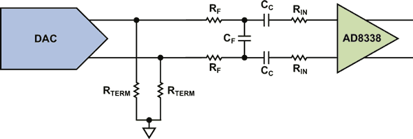

Modern DACs and DDS devices often have differential outputs, requiring designers to use a transformer, lose half of the signal with a single-ended connection, or add a differential-to-single-ended converter. The AD8338 provides a natural fit, having a fully differential interface, as shown in Figure 3. For a sine-wave application, the DAC would be replaced with a DDS.

Figure 3. Example of a network that interfaces a DAC to the AD8338.
A major feature of the AD8338 is the flexible input stage. As an input-VGA, it manipulates the input currents using the “H-amp” topology invented by ADI Fellow Barrie Gilbert. This design uses feedback to balance the input currents while maintaining the internal nodes at 1.5 V. Under normal conditions, using the 500-Ω input resistors, the maximum 1.5-V input signal produces a 3-mA current. If the input amplitude were larger, say 15 V, a larger resistor would be connected to the “direct” input pins. This resistor is sized such that the same 3-mA current is obtained:

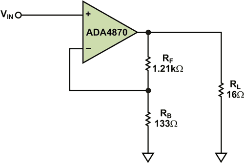

Advances in current-feedback amplifier (CFA) technology mean that this no longer has to be a problem. The ADA4870 [3] CFA can drive 1 A at 17 V on ±20-V supplies. For sine waves, it can output frequencies up to 23 MHz at full load, making it an ideal front-end driver for the next generation of general-purpose arbitrary waveform/signal generators.
For 50-Ω systems that are sensitive to reflections, the ADA4870 requires some passive devices to match the source impedance to the 50-Ω load: a resistive pad and a 1.5:1 RF autotransformer. Allowing 1 V of margin, 8-W peak power is obtained when the effective amplifier loading is 16 Ω. Alternatively, if reflections are not a concern, the resistive pad can be eliminated, and the autotransformer can be replaced with one with a 0.77:1 ratio. Without the resistive padding the output power increases to 16-W peak (28.3-V amplitude).

Figure 4. The basic connection for the ADA4870 for driving 16 Ω, gain = 10.

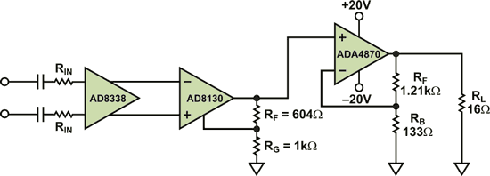

To optimize the output signal swing, the ADA4870 is configured for a gain of 10, so the required input amplitude is 1.6 V (Figure 4). The ADA4870 has a single-ended input, and the AD8338 has a differential output, so an AD8130 [4] differential- receive amplifier, with its 270-MHz gain-bandwidth product and 1090-V/µs slew rate, provides both the differential-to-single-ended conversion and the required gain. The AD8338’s output is constrained to ±1.0 V, so the AD8130 must provide an intermediate gain of 1.6 V/V. When combined, the three devices form a complete signal generator output stage (Figure 5).
Two New Devices Help Reinvent the Signal Generator
Figure 5. Signal generator output stage.
