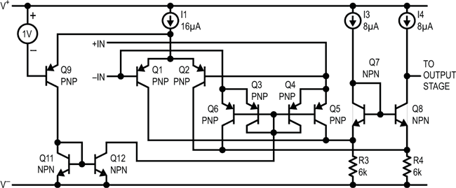

Input Topology—Theory of Operation
An Over-The-Top input stage is shown in Figure 1. At low common modes, the PNPs Q1 and Q2 form a conventional precision differential pair with tail current provided by I1. The diff pair forwards its collector currents into the folded cascode pair Q7, Q8, which then drive the output stage. As the common mode rises to within 1 V of the upper supply rail, Q9 begins to steal the tail current away from the diff pair and passes it through the Widlar of Q11, Q12 which then biases up the diode connected pair Q3, Q4 which in turn bias up the precision common base pair Q5, Q6. The collectors of Q5 and Q6 are paralleled into the same folded cascode as before. So the Q1, Q2 diff pair and the Q5, Q6 common base pair are essentially in parallel, with each pair handling a specific input common mode range. The true power of this approach is that Q12 (as well as all the other junctions involved) can handle a whopping 76 V. That means that the Q5, Q6 input stage is active and precise even when taken far above V+, and the op amp remains closed loop as long as the feedback can get up there too. Be aware that Q5 and Q6 do not provide current gain, so the LT6015 worst case offset current of 15 nA rises to 500 nA in Over-The-Top mode.
Robust High Voltage Over-The-Top Op Amps Maintain High Input Impedance with Inputs Driven Apart or When Powered Down
Figure 1. Over-The-Top Input Stage on LT6015 Can Common Mode to 76 V, Independent of Positive Supply Voltage

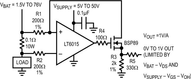

High Side Current Sense
The circuit of Figure 3 is a precision high side current sense amplifier that functions over a wide input common mode range and goes high impedance when its supply vanishes. The inputs of the op amp are held high, and feedback is level shifted “up there” through the FET. Because the FET operates from VBAT, the output clips as it approaches VBAT – VR1 – VDS. R1 and R3 set the gain accuracy. One might think R2 can be a 5% tolerance resistor, but it is added to accurately reject DC errors created by the input bias current, which is quite high in Over-The-Top mode, so 1% is not a waste. R4 is there for Jim Williams, who never wanted to see a MOSFET gate without a resistor on it. R5 is a current limiting resistor with a cautionary tale. If this circuit is operated at higher VBAT and VSUPPLY, and is driving downstream circuitry which is on lower supply, or is off, and the downstream circuitry has protection diodes to its rails, then unpredictable system glitches may drive the FET gate high, putting the full VBAT voltage across R3. R5 keeps any downstream protection diodes or short-circuits at some distance, and should be sized for value and power, assuming the FET can turn hard on. This is an example of circuit considerations necessary when designing robustness into high voltage systems.
Figure 3. High Side Current Sense Amp Operates Up to 76 V Even on a Single 5 V Supply.
FET Provides Feedback. Full Scale Output Is Limited by VBAT And VSUPPLY.
The 330 Ω Output Resistor Is Precautionary—See Text. For Robust Operation if
VSUPPLY Goes Low or Is Removed Completely, All Inputs Go High Impedance
So VBAT Is Not Loaded

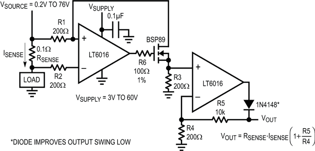

To extend the serviceability of the high side current sense amplifier to lower input voltages, the dual LT6016 can be used, as shown in Figure 4. Taking less gain in the first stage keeps the MOSFET source voltage low, allowing for a lower input common mode voltage limit down to 0.2 V. Circuit gain is recovered in the second amplifier stage.
Figure 4. Extended Range High Side Current Sense Amplifier with VSOURCE Down to 0.2 V
