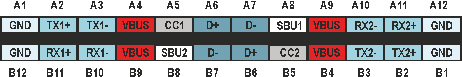

Figure 2 shows a USB Type-C receptacle pin map. The 24-pin interface is arranged in a symmetrical fashion and includes four pins for USB 2.0, eight pins (four pairs) for SuperSpeed USB, and two pins for alternate-mode, side-band signals. Additionally, two pins are used for channel configurations and USB-PD communications, four pins for VBUS, and four pins for GND. The connectors and cable assembly are defined such that SuperSpeed USB differential pairs can carry data up to 20 Gbps. While a receptacle must have all 24 pins, a Type-C USB 2.0 plug-and-cable assembly has only 12 signals, thus reducing cost.

A typical system implementation shorts two D+ and two D– signals with stub connections. This eliminates the need for a multiplexer (Mux) to accommodate a flippable plug. Such a stubbed connection for SuperSpeed USB signals is not feasible due to signal integrity concerns requiring two receiver (Rx) and transceiver (Tx) 2:1 multiplexers. This connection probably consists of one chip at each end of a Type-C interface, one at the host side, and one at the client device side. If an alternate mode is used, the Mux configuration becomes more complicated and requires crosspoint switches.

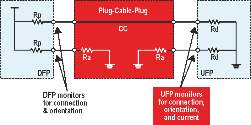

Even though a receptacle has two CC pins, CC1 and CC2, only a single CC wire is connected through the cable. While traditional USB ports determine host/device relationships using mechanical characteristics of receptacle and plugs, in USB Type-C with same connectors at both ends, a DFP has a pull-up and a UFP has a pull-down on the CC lines (Figure 3). Monitoring the CC lines for specified voltage provides the orientation and attachment detection.

A DFP uses different resistor pull-up (or current source) values to advertise its current provider capability. On the other hand, a UFP detects how much current it can consume by applying a pulldown resistor and performing a voltage comparison. Three power settings are possible for a USB 2.0 interface without USB-PD: 500 mA; 1.5 A; and 3 A with 5 V on VBUS.

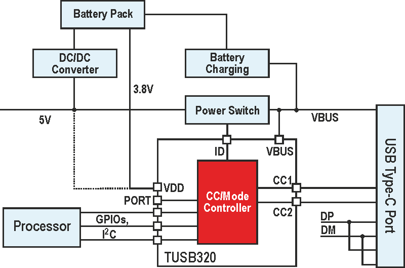

Typically, a mobile device has a DRP role such that it can be a power sink for charging when connected to a PC. Conversely, it can function as a source when it is paired with a flash drive. Figure 4 shows a typical USB 2.0 implementation of a DRP. Note how the system implementation remains mostly unchanged with a CC controller chip that emulates the ID signal of a standard OTG implementation. It is important to mention that USB Type-C enables a mobile device to be dual-role capable (host or client), as well as be a power source or sink.

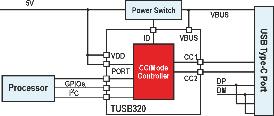

A USB 2.0 Type-C port in a laptop or wall charger most likely will be a DFP with a power provider role. Why does a laptop have a 15 W USB 2.0 port? The answer depends on the overall cost and power budget of a system with multiple Type-C ports because not all of them can be full-featured. A typical implementation of a DFP is illustrated in Figure 5. Even though the port is not taking a dual-role, the ID signal is useful for controlling the power FET.

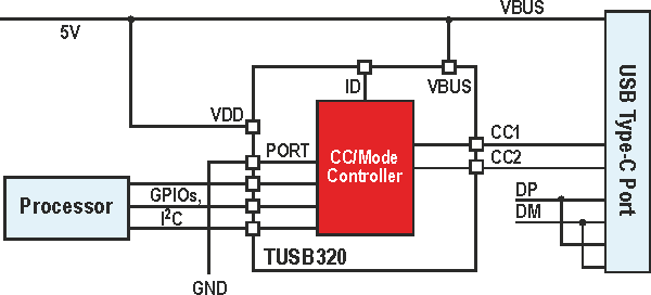

One-chip solution for USB 2.0
One device that can provide a single-chip implementation of USB 2.0 is the TUSB320 from Texas Instruments. When using this device, converting an existing USB 2.0 into Type-C is not as complicated as it may appear. You just swap the connector and add a CC controller such as the TUSB320, and you are almost done. All application examples illustrated on Figures 4-6 can be implemented using this device for DRP, DFP and UFP, respectively. The device can be configured by GPIOs. Using I2C is optional, but provides additional functions that a system designer might find useful. The device provides an I2C interrupt signal for a microprocessor in order to reduce constant polling. Any event that changes the state of the host-client interface will be notified.
TI’s DRP port controller provides CC logic and can be configured as a DFP, UFP or DRP for portable applications.

The device alternates, presenting itself as a DFP or UFP, according to the Type-C specification. The CC logic block monitors the CC1 and CC2 pins for pull-up or pull-down resistances to determine when a USB port is attached and its role. CC logic also advertises or detects Type-C current-mode default, mid or high, depending on the role detected. A list of supported features is summarized in Table 4.
