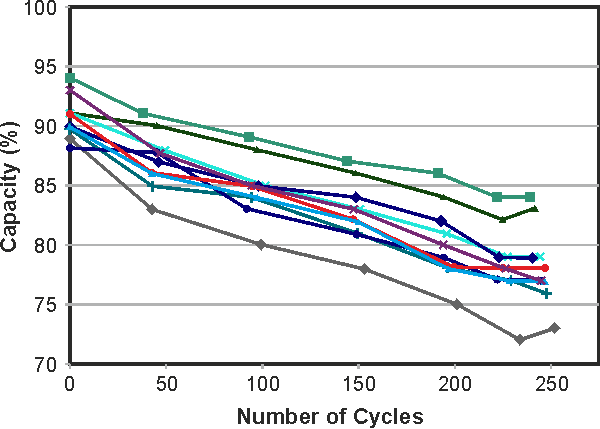

Figure 1 illustrates the capacity drop of 11 Li-polymer batteries that have been cycled at a Cadex laboratory. The 1,500 mAh pouch cells for mobile phones were first charged at a current of 1,500 mA (1C) to 4.20 V/cell and then allowed to saturate to 0.05C (75 mA) as part of the full charge saturation. The batteries were then discharged at 1,500 mA to 3.0 V/cell, and the cycle was repeated. The expected capacity loss of Li-ion batteries was uniform over the delivered 250 cycles and the batteries performed as expected.
BU-808: How to Prolong Lithium-based Batteries
Figure 1. Capacity drop as part of cycling. Eleven new Li-ion were tested on a Cadex C7400
battery analyzer. All packs started at a capacity of 88–94% and decreased to
73–84% after 250 full discharge cycles. The 1500 mAh pouch packs are
used in mobile phones. Courtesy of Cadex.
Although a battery should deliver 100 percent capacity during the first year of service, it is common to see lower than specified capacities, and shelf life may contribute to this loss. In addition, manufacturers tend to overrate their batteries, knowing that very few users will do spot-checks and complain if low. Not having to match single cells in mobile phones and tablets, as is required in multi-cell packs, opens the floodgates for a much broader performance acceptance. Cells with lower capacities may slip through cracks without the consumer knowing.

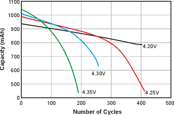

For safety reasons, many lithium-ions cannot exceed 4.20 V/cell. (Some NMC are the exception.) While a higher voltage boosts capacity, exceeding the voltage shortens service life and compromises safety. Figure 2 demonstrates cycle count as a function of charge voltage. At 4.35 V, the cycle count of a regular Li-ion is cut in half.
Figure 2. Effects on cycle life at elevated charge voltages. Higher charge voltages
boost capacity but lowers cycle life and compromises safety.
Besides selecting the best-suited voltage thresholds for a given application, a regular Li-ion should not remain at the high-voltage ceiling of 4.20 V/cell for an extended time. The Li-ion charger turns off the charge current and the battery voltage reverts to a more natural level. This is like relaxing the muscles after a strenuous exercise. (See [4].)
