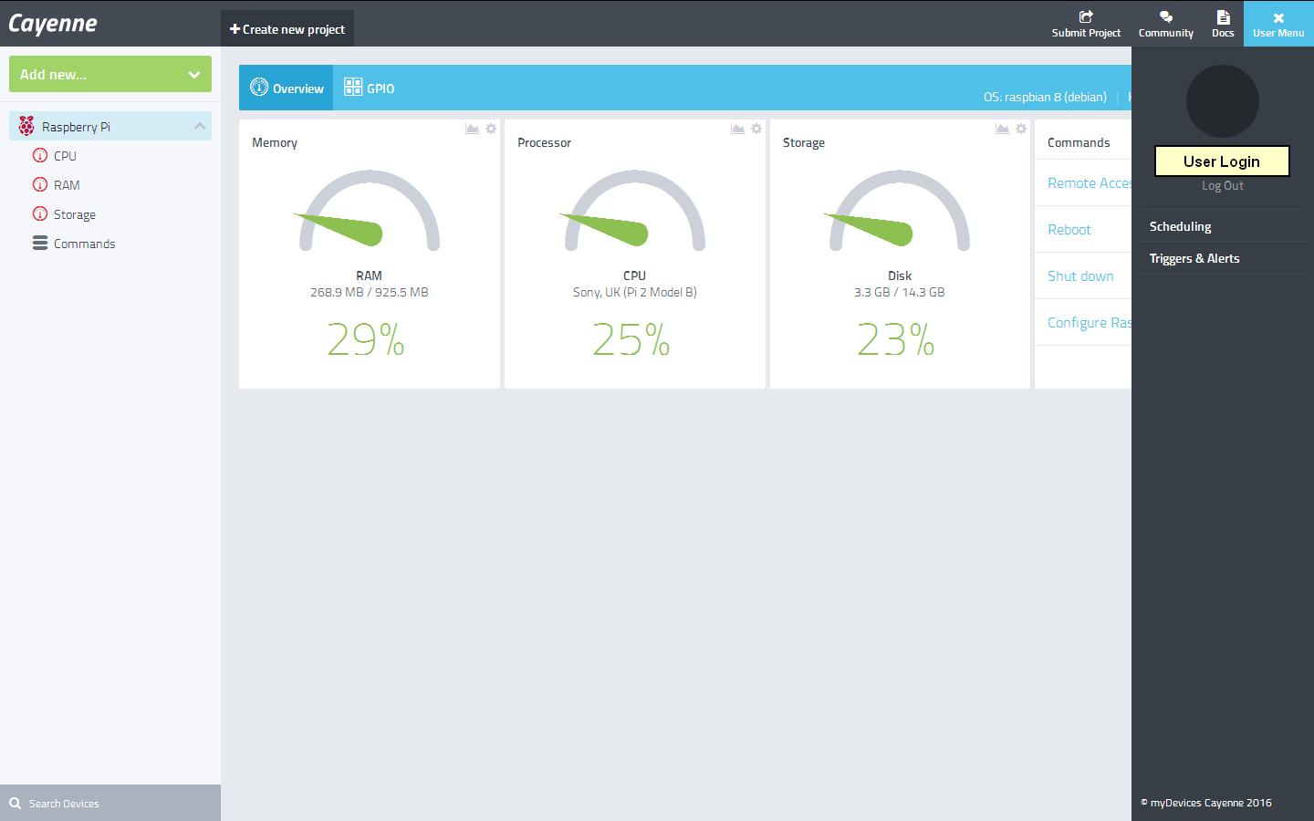

Further, in the article I will use the system's web interface. The user interface of the mobile application is identical, differing only in some elements of design and management methods. Having dealt with the web interface, you can easily find out the mobile app too.
At the first system’s start, you will see on the desktop default 3 widgets reporting CPU usage and memory status. More default widgets informing about CPU temperature, system processes and network connection speed added to the mobile application. The control panel for adding sensors and actuators, as well as additional RPi boards, located on the left side. I was not mistaken, the user in a single project can merge several single-board computers that perform different tasks and write triggers to automate any processes in the system.
Menu with account information, remote RPi board settings and management tools is on the right side. Commands on RPi board restart and shutdown, webcam and communication interfaces (I2C, SPI, UART, 1-Wire,) turn on/off (if connected) and remote Raspbian desktop connect (in web browser) are available. By connecting to the remote desktop user gets full access to the RPi operating system (Figure 3).

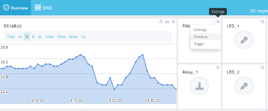

On the dashboard (this definition is more appropriate for the respective graphic design) users can add sensor, I/O ports and actuators widgets. The ability to configure the widgets on the dashboard allows you to create different projects of graphic interfaces (Figure 4).
Cayenne: User can configure the widgets style and change their location on the dashboard.
Figure 4. User can configure the widgets style and change their

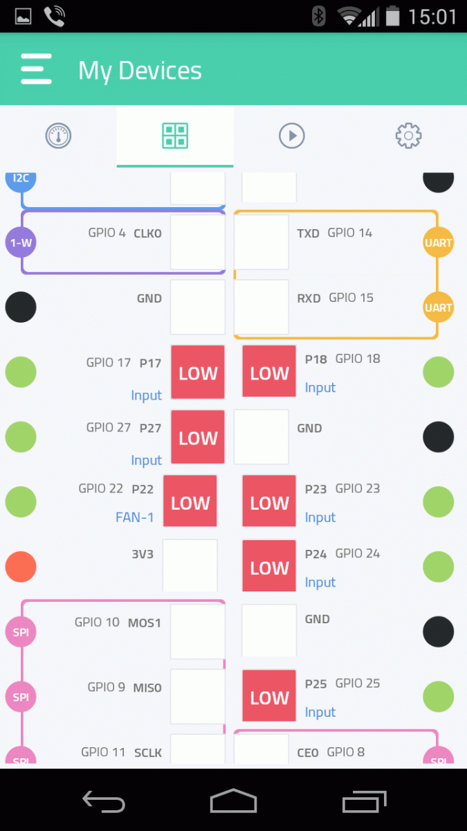

The dashboard has another very useful bookmark – Raspberry Pi GPIO connector interactive map (Figure 5). The user sees the I/O lines purpose, the current configuration and the logical state, and can configure the available ports (input/output) and change the logic state. If the user employ any available port for their own purposes (add a widget on dashboard), then on the GPIO map will be displayed name of the widget on the corresponding pin. It is useful for expanding functionality and adding new devices.
Cayenne: Interactive GPIO map of the Raspberry Pi Expansion connector
a)
b)
Figure 5. Interactive GPIO map of the Raspberry Pi Expansion connector:
a) Web-based interface, b) mobile application.
Triggers editor for and scheduler (Scheduling) are available in the user’s menu or directly in the widget properties (Figure 6).
Cayenne: Редактор алгоритмов автоматизации и планировщик доступны в настройках виджетов
Figure 6. Triggers Editor and Scheduling are available in the widget settings.

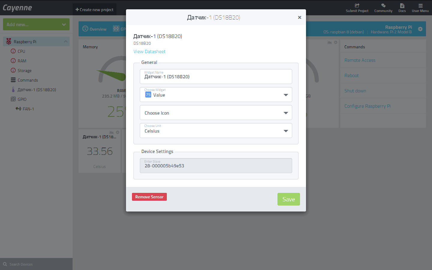

We can run RPi after connecting external peripherals and verification of mounting.   Starting the operating system and connection to Cayenne cloud service will take about 4-5 minutes. After that, as in the web interface or mobile app are connected to the remote device, we can start to add devices and control widgets. In my case, DS18B20 temperature sensor was automatically detected and successfully appeared on the dashboard after connecting Rpi to Cayenne temperature widget. It was only need to configure it (Figure 10). All data from the temperature sensor are collected by system for the further displaying in statistical charts. In addition, the user can download the data in CSV format for processing in other programs.
Cayenne: Configuring the DS18B20 temperature sensor widget.
Figure 10. Configuring the DS18B20 temperature sensor widget.

All the available I/O channels are displayed on the GPIO map. The configuration of ports (input/output) is automatically changed depending on the connection type.

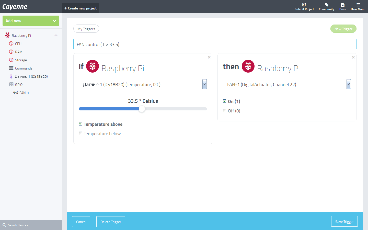

Now we can start to build triggers on the example of ambient temperature monitoring. Creating an event handler is executed in the If-Then style structure (Figure 12) and requires minimum user actions:
Cayenne: Triggers Editor for creating automation algorithms, setting the fan switch-on conditions.
Figure 12. Triggers Editor for creating automation algorithms,
  • drag the required RPi device (remember, we can control several RPi boards), to which appropriate sensor is connected from control panel in the If operator field;
  • in If operator we choose temperature sensor and set the desired switching threshold (for example, the temperature is above 25 °C);
  • in Then operator's field drag from control panel required RPi device that is connected to the actuator (FAN_1);
  • select the I/O channel and set the active state (On (1) / Off (0))
  • assign a trigger name and save.
From that moment, the fan will turn on if the condition that the ambient temperature is above 25ºC. Next, in the same way you can add conditions to the fan off. The more sensors that monitor the state of the environment, the more flexible triggers can be created and controlled. Additionally, here you can create a text user notifications about running triggers.
