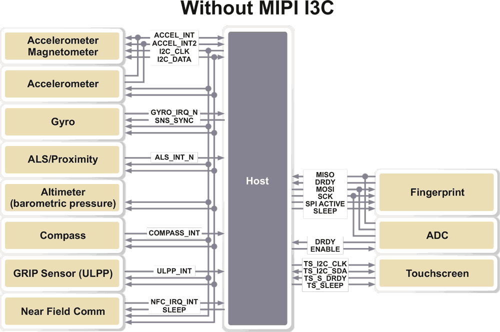

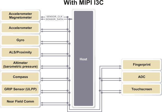

  • One key is MIPI I3C’s 2-wire interface with in-band interrupt capability, which drastically reduces pin count and signal paths and facilitates incorporation of more sensors in a device.
  • On a standard CMOS I/O, MIPI I3C supports a minimum data rate of 10 Mbps with options for higher performance, high-data-rate modes. This is a leap in performance and power efficiency compared to previous options.
  • MIPI I3C provides synchronous and asynchronous time-stamping to improve the accuracy of applications that use signals from various sensors.
  • MIPI I3C also enables sensors to be always-on, even if other components in a device are asleep, while operating at very low power to minimize impact on battery life.
It’s important to note that MIPI I3C isn’t just targeted to support sensors in mobile, but also IoT and other low-power system architectures with greater bandwidth while requiring fewer wires.
