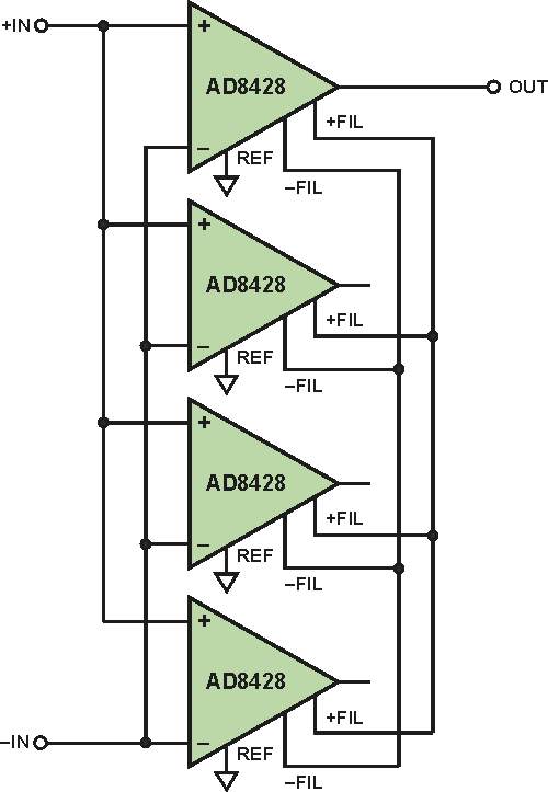

Figure 1 shows a circuit configuration that further reduces the system noise. The inputs and filter pins of four AD8428s are shorted together, reducing the noise by a factor of 2.
The output can be taken from any one of the in-amps to maintain low output impedance. This circuit can be extended, dividing the noise by the square root of the number of amplifiers used.

The 1.3 nV/√Hz typical referred-to-input (RTI) spectral noise generated by each AD8428 is uncorrelated with the noise generated by the other amplifiers. The uncorrelated noise sources add as the root-sum-of-squares (RSS) at the filter pins. The input signal, on the other hand, is positively correlated. Each AD8428 generates the same voltage at its filter pins in response to the signal, so connecting multiple AD8428s doesn’t change the voltage, and the gain remains 2000.

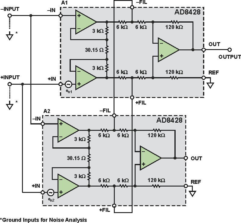

The following analysis of the simplified version of the circuit in Figure 2 shows that two AD8428s connected this way reduces the noise by a factor of √2. The noise of each AD8428 can be modeled at its +IN pin. To determine the total noise, ground the inputs and use superposition to combine the noise sources.

Noise source en1 gets amplified by a differential gain of 200 to the output of preamplifier A1. For this part of the analysis, the outputs of preamplifier A2 are noiseless with grounded inputs. The 6 kΩ/6 kΩ resistor divider from each output of Preamplifier A1 to the corresponding output of Preamplifier A2 can be replaced by its Thévenin equivalent: half of the noise voltage at the output of Preamplifier A1 with a 3 kΩ series resistor. This division is the mechanism that reduces the noise. The full nodal analysis shows that the output voltage in response to en1 is 1000 × en1. By symmetry, the output voltage in response to noise voltage en2 is 1000 × en2. The magnitude of en1 and en2 are both equal to en, and will add as RSS, causing an overall output noise of 1414 × en.
In order to refer this back to the input, the gain must be verified. Assume a differential signal VIN is applied between +INPUT and –INPUT. The differential voltage at the output of the first stage of A1 will be VIN × 200. The same voltages appear at the outputs of Preamplifier A2, so there is no signal division through the 6 kΩ/6 kΩ divider, and nodal analysis shows an output of VIN × 2000. Thus, the total voltage noise RTI is en × 1414/2000, or equivalently en/√2. Using the 1.3 nV/√Hz typical noise density of the AD8428, the two amplifier configuration yields a noise density of about 0.92 nV/√Hz.
With additional amplifiers, the impedance at the filter pin changes, reducing the noise further. For example, using four AD8428s as shown in Figure 1, the 6 kΩ resistor from the preamplifier output to the filter pin is followed by three 6 kΩ resistors to each of the noiseless preamplifier outputs. This effectively creates a 6 kΩ/2 kΩ resistor divider, dividing the noise by four. The total noise of all four amplifiers then becomes en/2, as predicted.

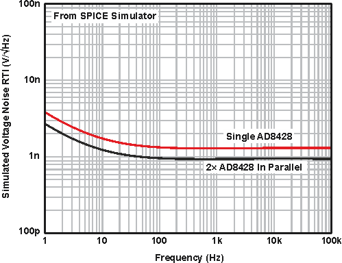

Although it should not be used as a substitute for prototyping, circuit simulation with SPICE can be a useful first step in validating circuit ideas such as this. To verify this circuit, the ADIsimPE simulator and the AD8428 SPICE macro model were used to simulate the circuit performance with two devices in parallel. The results shown in Figure 3 demonstrate the expected behavior: a gain of 2000 and 30% lower noise.

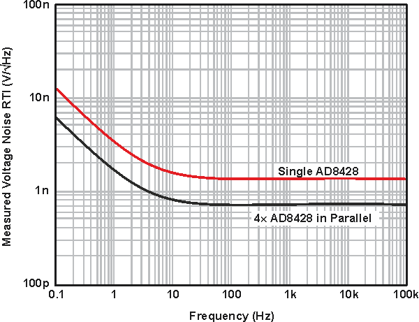

Figure 4. Measured voltage noise spectrum of circuit shown in Figure 1.

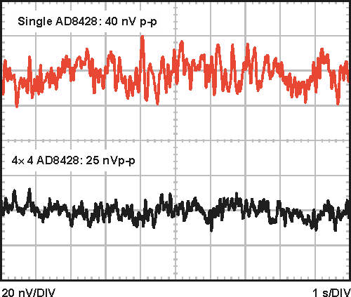

The full circuit with four AD8428s was measured on the bench. The measured RTI noise has a spectral density of 0.7 nV/√Hz at 1 kHz and 25 nV p-p from 0.1 Hz to 10 Hz. This is lower than the noise of many nanovoltmeters. The measured noise spectrum and peak-to-peak noise are shown in Figure 4 and Figure 5, respectively.
No Pain, High Gain: Building a Low Noise Instrumentation Amplifier with Nanovolt Sensitivity
Figure 5. Measured 0.1 Hz to 10 Hz RTI noise of circuit
