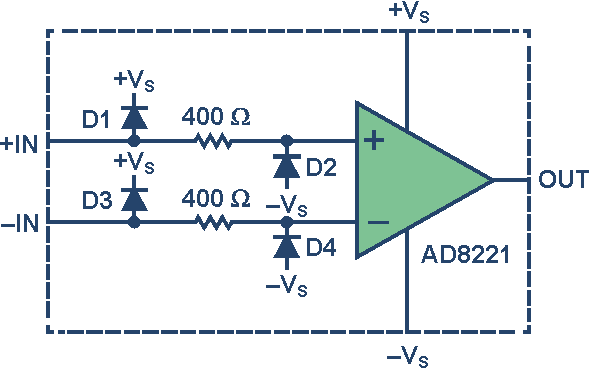

Diode connected to the power supply
Figure 1 shows an example of an amplifier with diodes connected between the input pins and the supplies. The diodes are reverse biased under normal operating conditions, but become forward biased as the inputs rise above the positive supply voltage or below the negative power supply voltage. As the diode becomes forward biased, current flows through the amplifier’s inputs to the respective supply.
Using ESD Diodes as Voltage Clamps
Figure 1. Input ESD topology of AD8221
In the case of the circuit in Figure 1 the input current is not inherently limited by the amplifier itself when the overvoltage goes above +Vs, and will require external current limiting in the form of a series resistor. When the voltage goes below –Vs the 400 Ω resistor provides some current limiting, which should be factored into any design considerations.

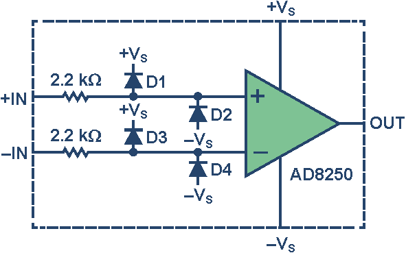

Figure 2 shows an amplifier with a similar diode configuration, but in this case the current is limited by the internal 2.2 kΩ series resistor. This differs from the circuit shown in Figure 1 by not only the value of the limiting R but also the 2.2 kΩ protects from voltages above +Vs. This is an example of the intricacies that must be fully understood to optimize protection when using ESD diodes.

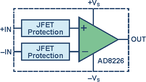

Current limiting JFETs
In contrast to the implementation in Figure 1 and 2, current limiting JFETs may be used in IC designs as an alternative to diode clamps. Figure 3 shows an example where JFETs are used to protect a device when the input voltages exceed the specified operating range of the device. This device is inherently protected up to 40 V from the opposite rail by the JFET inputs. Because the JFET will limit the current into the input pins, the ESD cells cannot be used as additional overvoltage protection.
Figure 3. Input protection scheme of AD8226
Where voltage protection up to 40 V is required, this device’s JFET protection offers a well-controlled, reliable, fully specified option for protection. This is often in contrast to using ESD diodes for protection, where information on diode current limits are often specified as typical, or possibly not specified at all.

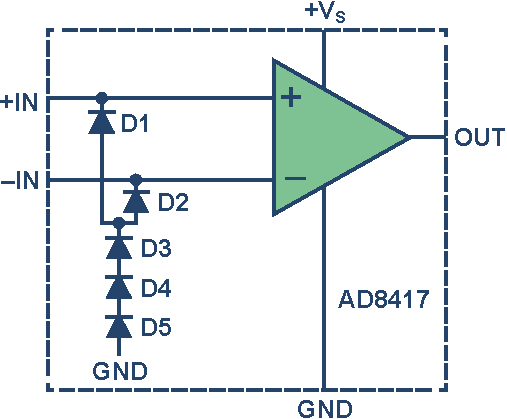

Diode stacks
In applications where the input voltage is allowed to exceed the power supply voltage or ground, a stack of diodes may be used to protect the input from ESD events. Figure 4 shows an amplifier that implements a stacked diode protection scheme. In this configuration, the diode string is used to protect from negative transients. The string of diodes are used to limit the leakage current in a usable input range, but provide protection when the negative common mode range is exceeded. Keep in mind the only current limiting will be the equivalent series resistance of the diode string. An external series resistance can be used to decrease the input current for a given voltage level.

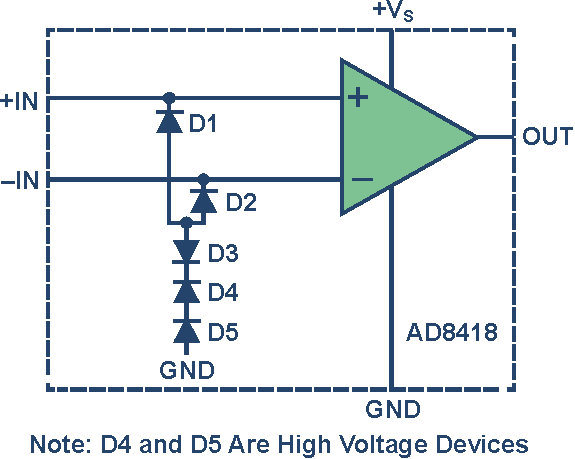

Back to Back Diodes
Back to back diodes are also used when the input voltage range is allowed to exceed the power supply. Figure 5 shows an amplifier that implements back to back diodes to provide ESD protection on a device that allows voltages up to 70 V using a 3.3 V supply. D4 and D5 are high voltage diodes used to standoff the high voltages that could be present on the input pins and D1 and D2 are used to prevent leakage currents while the input voltages are within the normal operating range. In this configuration, using these ESD cells for overvoltage protection would not be recommended because exceeding the maximum reverse bias of the high voltage diode can easily lead to situations that cause permanent damage.

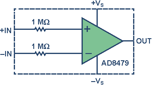

No ESD clamps
Some devices do not include ESD devices on the front end. While it is obvious that a designer cannot use ESD diodes for clamping if they are not there, this architecture is mentioned as a situation to look out for when investigating overvoltage protection (OVP) options. Figure 6 shows a device that uses only large value resistors to protect the amplifier.
Figure 6. Input protection scheme of AD8479

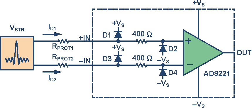

In addition to understanding how the ESD cells are implemented, it is important to understand how to utilize the structures for protection. In a typical application, a series resistor is used to limit the current over a specified voltage range.
Figure 7. Using ESD Cells as Clamps
When amplifiers are configured as shown in Figure 7 or where the inputs are protected by a diode to the supply, input current is limited using the equation in the following formula.
  (1)
An assumption used for formula 1 is that VSTR > VSUP. If this is not the case, a more precise diode voltage should be measured and used for the calculation instead of the 0.7 V approximation.
An example calculation follows for protecting an amplifier using ±15 V supplies, from input stresses up to ±120 V, while limiting the input current to 1 mA. Using Equation 1, we can use these inputs to calculate the following.
  (2)
  (3)
Given these requirements, an RPROT >105 kΩ would limit the diode current to <1 mA.
