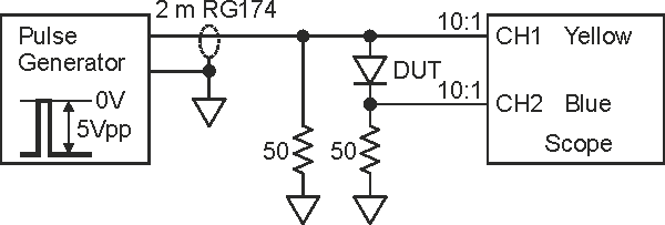

This left only the unknown junction capacitance, Cj, and reverse recovery time, Trr. This is the time that a diode remains conducting when suddenly switched from forward to reverse biased. I had to figure out a way to measure these parameters. Not with exotic equipment; just enough to get in the ballpark – in other words, a function generator with a falltime of 40 ns, and a 100 MHz scope, which was all I had to work with.
Easily measure diode capacitance and reverse recovery
The test setup was easy: Drive the diode-under-test (DUT) with a 5 V pulse – DC offset set mostly negative to bias the diode on only during positive peaks. Scope both sides of the DUT and trigger on the turn-off edge. Varying the DC voltage offset controls the DUT forward voltage and conduction current. Measure the DUT conduction current as the voltage dropped across its series 50 Ω resistor.

The time scale of 100 ns/div is constant for all images for ease of comparison.
