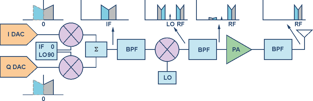

Conventional radio equipment has used high speed data converters in conjunction with quadrature modulators as some of the main building blocks for a wired or wireless communication link. The classic heterodyne, super heterodyne, and direct conversion architectures share the common need for data converters in the transmitter and the receiver to cross the boundary from digital processing to the real-world analog signals and back. Along with filter technology and power amplifier technology, data converter technology improvements set the pace for advances in radio design.
A classic radio transmitter implemented with a set of baseband high speed DACs is shown in Figure 1. The digital baseband data is sent through two synchronized high speed data converters, with in-phase data going through the I DAC and the quadrature data going through the Q DAC. The outputs of the DACs are sent to a quadrature modulator. Based on the type of modulator, its output can be a low intermediate frequency, such as 200 MHz to 400 MHz, a higher IF frequency such as 500 MHz to 1 GHz, or even an RF frequency in the 1 GHz to 5 GHz range. The diagram shows a subsequent upconversion to an eventual final frequency. The resulting signal is filtered with a band-pass filter and then sent through a power amplifier and another band-pass filter that may be part of a duplexer, for example.
New RF DAC Broadens Software-Defined Radio Horizon
Figure 1. Illustration of a classic super heterodyne transmitter using high speed data converters.
The instantaneous bandwidth that is typically transmitted with such an architecture is tens to a few hundred MHz, limited mainly by the converter, power amplifier, and filter bandwidths. This is not enough for some systems, such as new E-band microwave backhaul radios that require 500 MHz, 1 GHz, or even 2 GHz radio channels. If a multiband radio is considered, such as might be implemented in a wireless infrastructure base station, an equally wide spacing of 500 MHz or 700 MHz or even 1 GHz may be required to cover some band combinations. A conventional radio would address that by implementing two radios, one for each band. It may be more desirable to combine radios into one radio chain, whether it be for cost or size or some other factor. In this case, a new approach is needed.

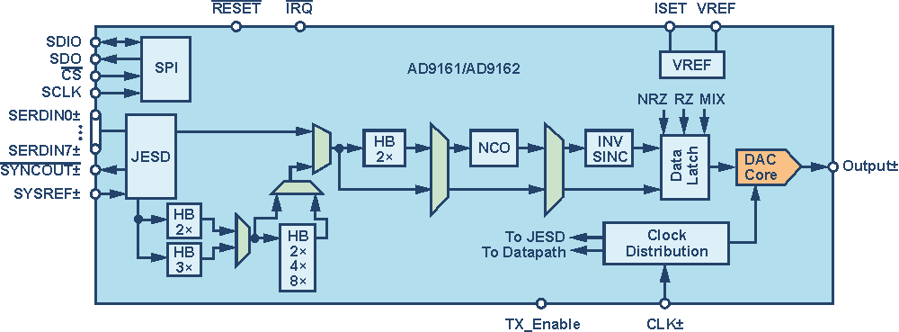

A good example of this is the AD9162 and AD9164 series of RF DACs. A block diagram of the AD9162 and AD9164 is shown in Figure 2. The AD9162 is a 16-bit, 6 GSPS RF DAC with several options of interpolation, from 1× bypass mode up to 24× interpolation. The interpolators operate on a classic 80% bandwidth or a wider 90% bandwidth for more instantaneous signal bandwidth at slightly higher power. The datapath also has a final half-band interpolator, FIR85, shown as the “HB 2×” block prior to the NCO in Figure 2, that effectively doubles the DAC update rate to up to 12 GSPS, moving images further away and easing filtering requirements. The optional FIR85 is followed by a 48-bit numerically controlled oscillator (NCO) that operates at either the 6 GSPS update rate or the 12 GSPS update rate when FIR85 is enabled. Following the NCO is an x/sinx compensation filter that corrects for the sinx/x roll-off of the DAC by pre-emphasizing the input to the DAC core.
Figure 2. Block diagram of the AD9162 and AD9164 family of RF DACs.
The DAC core is designed with Analog Devices’ patented Quad Switch architecture, delivering superior spurious-free dynamic range (SFDR) and noise spectral density (NSD), resulting in the industry’s best dynamic range, while also providing the familiar DAC decoder options the Quad Switch enables: non-return-to-zero (NRZ) mode, return-to-zero (RZ) mode, and Mix-Mode™. The FIR85 adds a new feature to the DAC decoder called 2xNRZ mode, which will be described in more detail later.
The AD9164 has the base features of the AD9162, and it adds a direct digital synthesis (DDS) function in the form of a fast frequency hopping (FFH) NCO engine. The FFH NCO has several unique features that make it quite attractive for markets such as high speed test instrumentation, local oscillator replacement, secure radio communications, and radar exciters. The FFH NCO engine is implemented with thirty-two 32-bit NCOs, each with its own phase accumulator, and a selection block that enables the fast frequency hopping.
The AD9162 has two derivative products that are directed to specific markets. The AD9161 is an 11-bit, 6 GSPS RF DAC that has a minimum 2× interpolation. The SFDR and NSD of the AD9161 are suitable for cable head end and remote PHY applications and meet DOCSIS 3.0 specifications. The reduced signal bandwidth and dynamic range remove requirements for an export license for the AD9161. The AD9163 is a 16-bit, 6 GSPS RF DAC that has minimum 6× interpolation and retains the full dynamic range of the main product AD9162. The full dynamic range of the device and its wide 1 GHz instantaneous bandwidth plus full range NCO make the device suitable for single-band or dual-band wireless infrastructure base stations and also point-to-point microwave systems in the traditional bands, while also having the benefit of not requiring an export license. Table 1 summarizes the product family and key features.

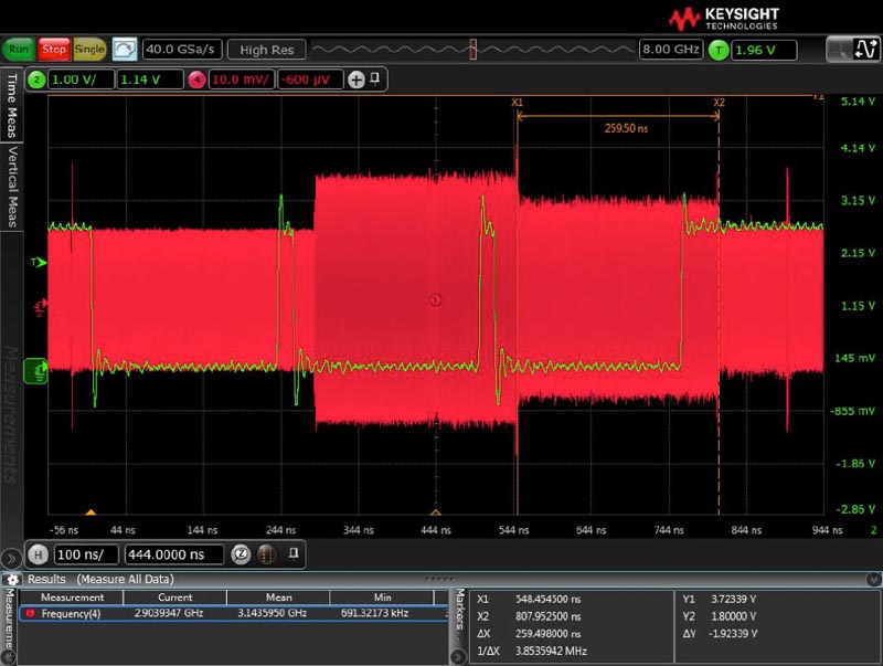

The AD9164 adds an important feature to the NCO – the fast frequency hopping NCO (FFH NCO). The FFH NCO is implemented with an additional thirty-one 32-bit NCOs, each with their own phase accumulator. Each NCO has its own FTW, so that a total of 32 NCO FTWs can be programmed in the device. An FTW select register is provided so that a single SPI register byte write can accomplish a hop to a new frequency with accuracy to 32 bits. With the 100 MHz SPI, this means a new FTW can be chosen in 240 ns, with the single byte write.
The FFH NCO has an additional phase coherent frequency hopping mode that makes it attractive for instrumentation and military applications. Phase coherent frequency hopping is important for test applications and also radar applications that need to track the phase of an exciter signal for use later. Phase coherent frequency hopping enables changing from one frequency to another and back to the original one again, without losing track of the original frequency’s phase accumulation. Stated another way, it enables changing from one frequency to another and back again, and appearing as though the frequency was never changed.

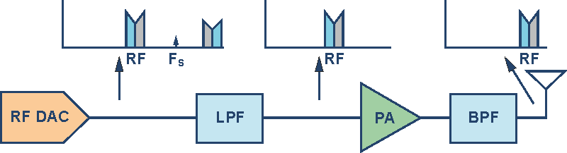

The signal processing features and high sample rate of the AD9162 and AD9164 enable a simplification of the radio architecture in Figure 1. The updated drawing is shown in Figure 3. Because the RF data converter can directly synthesize signals at the desired output frequency, there is no longer a need for a quadrature modulator or an upconverting mixer. The signal is created in the digital processor and simply played out of the RF data converter. The amount of hardware needed to implement the transmitter is thus greatly reduced. In addition, the radio is simpler to implement, with no need to calibrate the LO and DAC inputs to a quadrature modulator to suppress LO leakage and unwanted image, because the modulator is implemented digitally inside the RF data converter.
Figure 3. Radio transmitter architecture implemented with an RF data converter.

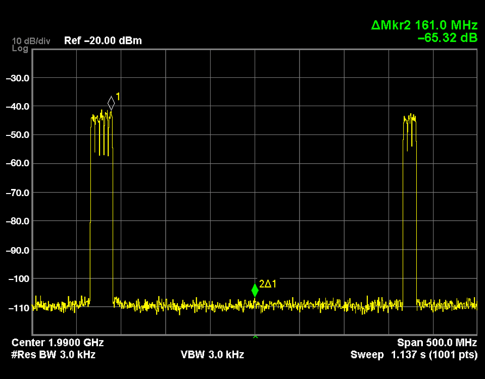

Figure 4. Dual-band WCDMA signal at 1.8 GHz and 2.1 GHz bands.
This type of architecture, with only an analog low-pass filter to filter the data converter’s image, opens up possibilities for reconfigurable or software-defined radios. The same digital part, RF data converter, and reconstruction low-pass filter could be used, with only a power amplifier and band-pass filter change, to implement a number of different radios. Figure 4 shows an example of a wireless base station dual-band transmitter output of five 5 MHz WCDMA carriers at 1800 MHz and three 5 MHz WCDMA carriers at 2100 MHz. Figure 5 shows an example of a compliant cable head-end transmitter output of 194 6 MHz wide 256 QAM carriers in the 50 MHz to 1.2 GHz spectrum of DOCSIS 3.1. Figure 6 shows an example of a fast frequency hopping dwell time of 260 ns, with 240 ns of register programming (single byte write) and 20 ns of hop time. Figure 7 shows the excellent phase noise performance of the AD9164, with better than –125 dBc/Hz at 10 kHz offset when running from a 4 GHz ovenized crystal oscillator and synthesizing a 3.9 GHz sine wave.

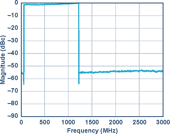

Figure 5. 194 6 MHz 256 QAM signals in the DOCSIS 3.1 frequency
band (50 MHz to 1.2 GHz).

Figure 6. Fast frequency hopping performance of the AD9164 –
260 ns dwell time per hop.

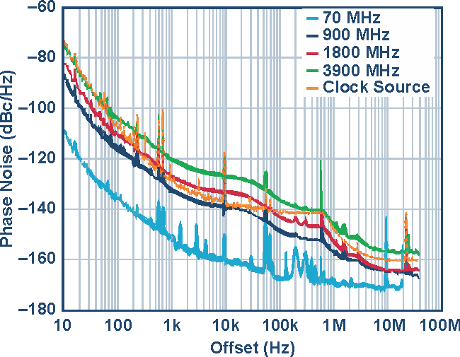

Figure 7. Aggregate phase noise performance of the AD9164. DAC clock signal source:
4 GHz ovenized crystal oscillator up to 600 kHz offset, then signal generator
above 600 kHz offset.
