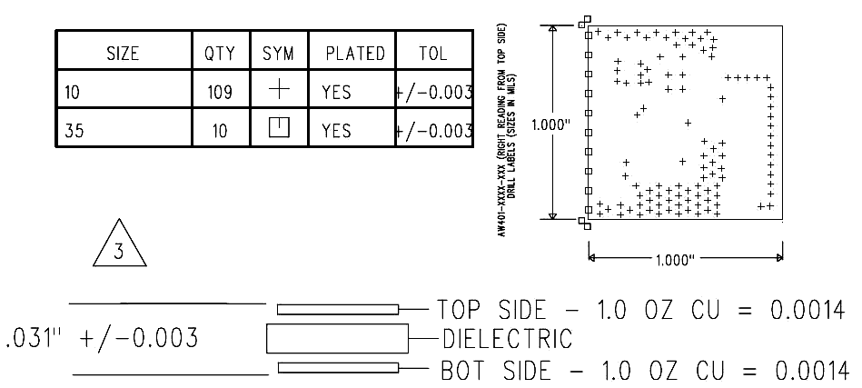

Figure 6. Drill & Layer Data
The drill and layer data is provided in Figure 6. The reference design is implemented on a two-sided 0.031 inch board with 1 oz copper traces.
