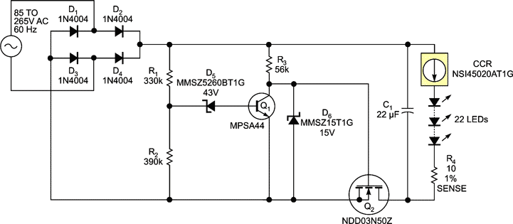

The circuit in Figure 1 comprises a bridge, a chopper, and a current regulator. The full-wave bridge comprising diodes D1, D2, D3, and D4, feeds into the chopper circuit. MOSFET Q2 immediately turns on, and capacitor C1 begins to charge.
Driver circuit lights architectural and interior LEDs
Figure 1. This circuits drives a string of LED with a constant current over the entire wordwide range of ac-mains voltages.
Resistors R1 and R2 form a voltage divider. When the voltage on the cathode of D5 reaches 43.5V, the zener diode conducts and turns on Q1, which pulls the gate of Q2 low, causing it to turn off. Diode D6 protects Q2’s gate.
The voltage across C1 stays at 80 to 90V. The charge on C1 feeds the CCR (constant-current regulator) and the LED string. This circuit example has 22 LEDs. The CCR maintains the current at 20 mA through the LED string. The circuit includes resistor R4, in series with the LEDs, for measuring the current through the LED string.

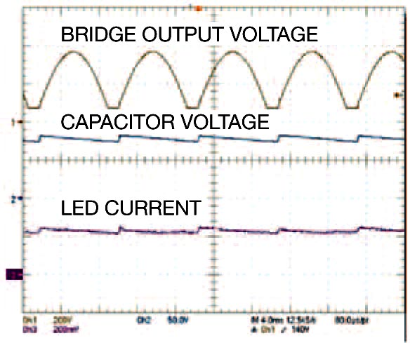

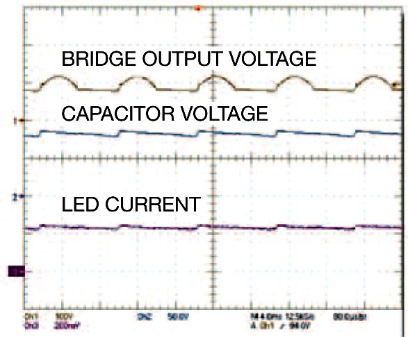

Figure 2 shows the voltages at different parts of the cycle with an input voltage of 150V ac. Trace 1 is the output of the bridge-rectifier circuit. Trace 2 is the voltage across C1, the output of the chopper circuit. Trace 3 is the voltage across the current-sense resistor. The traces clearly show that, when the voltage from the bridge increases to more than 80V, the chopper circuit switches and limits the voltage applied to the regulator circuit. Figure 3 shows the voltages with an input voltage of 85V ac.
When the voltage from the bridge increases to more than 80V, the chopper circuit switches and limits the voltage applied to the regulator circuit. At 85V AC, the circuit continues to operate by keeping Q1 on for a longer period
Figure 2. When the voltage from the bridge increases to more than 80V, the chopper circuit switches and limits the voltage applied to the regulator circuit. Figure 3. At 85V AC, the circuit continues to operate by keeping Q1 on for a longer period.
The oscilloscope traces show that there is still sufficient design head room, with Q1 staying on for a longer period, during which C1 fully charges. The input voltage drops to 54V ac before the current through the LEDs begins to drop.

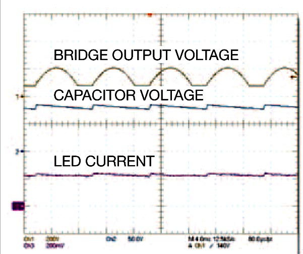

At 265V AC, the circuit has enough energy to keep C1 charged during off cycles
Figure 4. At 265V AC, the circuit has enough energy to keep C1 charged during off cycles.
Figure 4 shows the circuit operation at an input voltage of 265V ac. Trace 1 shows that, because of its high input voltage, Q1 is on for a short time. Trace 2, however, shows that sufficient energy still remains to charge Q1 and maintain the current through the LEDs during the off cycle.
You can scale this circuit to operate with different LED arrays. CCRs are available with current ratings as high as 160 mA. For higher currents, you can place the CCRs in parallel. The values of C1, R1, and R2 match the type and number of LEDs.
