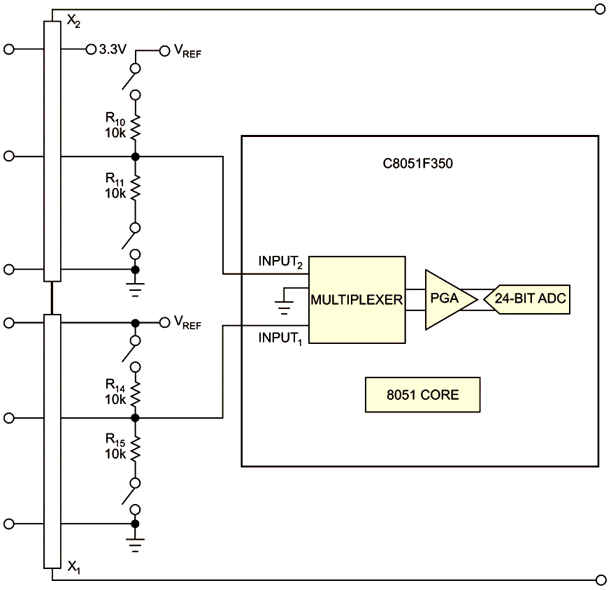

Two configurable analog ports allow you to connect many sensor types using two three-input connectors, each of which has a ground pin (Figure 4). One ground pin provides 3.3V power, and the other outputs the buffered reference voltage – nominally, 2.5V. Wire the central pins of the two connectors to the microcontroller’s analog-input multiplexer. In this way, you can either measure two single-ended voltages or use these two connectors as differential inputs. Both inputs have individually switched pullup and pulldown resistors, R10, R11, R14, and R15.
Fabricate a high-resolution sensor-to-USB interface
Figure 4.
You create two configurable analog ports that allow you to connect many sensor types using two three-input connectors, each of which has a ground pin.

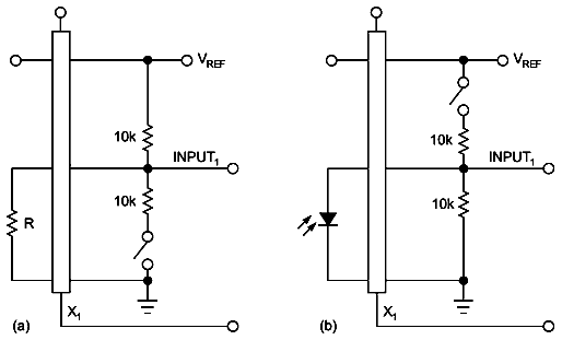

The analog-input architecture allows you to directly connect many kinds of sensors. For example, you can connect a thermistor or a photoresistor between the ground and the input pins and switch on the pullup resistor to form a voltage divider; the on-chip ADC can directly digitize this voltage divider’s output (Figure 5). This approach also features ratiometric operation, meaning that the ADC uses the same reference as the driving voltage of the voltage divider. Current-output sensors can also be connected as you would connect photodiodes – directly between the ground and the input pins. Switch the pulldown resistor so that the photocurrent develops a voltage.
Figure 5.
You could configure analog-input port X1 for a resistive sensor (a) and for a current-output sensor (b), such as a thermistor or a photodiode.

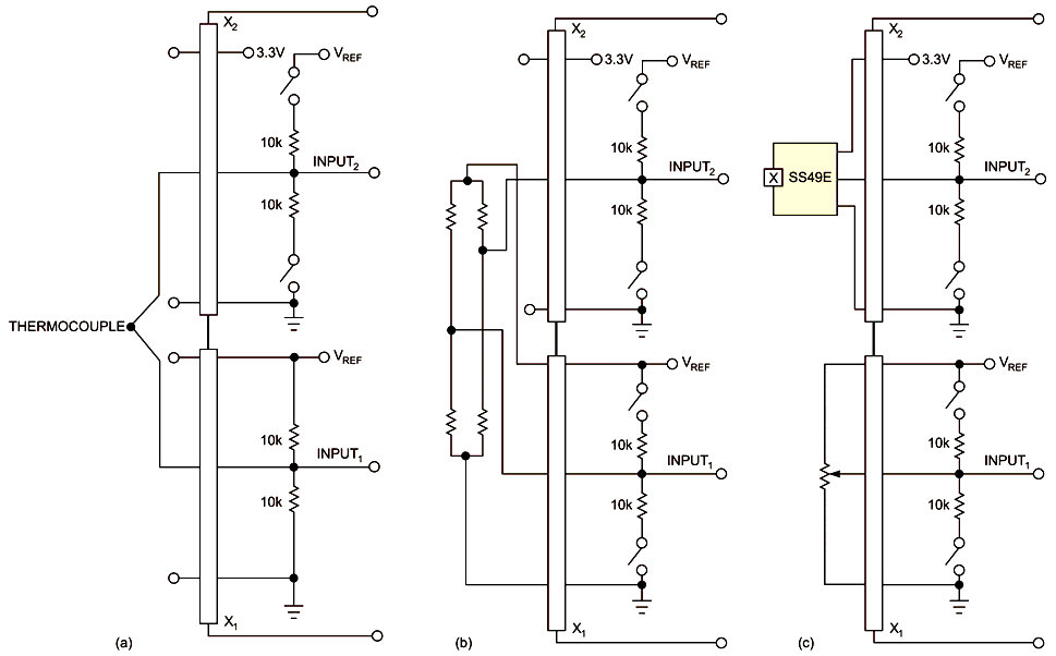

The high-resolution ADC and PGA allow direct connection of thermocouples (Figure 6). You achieve the required bias point by switching on both the pullup and the pulldown resistors on one channel. You can use directly connected bridge-type sensors, such as load cells and pressure sensors, by switching off all of the internal resistors. In these cases, you should operate the ADC in differential mode. Leaving all of the switches open also suits use in potentiometer inputs or IC sensors, such as the SS49E Hall-effect magnetic-field sensor.
Figure 6.
You can directly connect small-output voltage sensors (a), resistor bridges (b), or IC sensors and potentiometric sensors (c).
