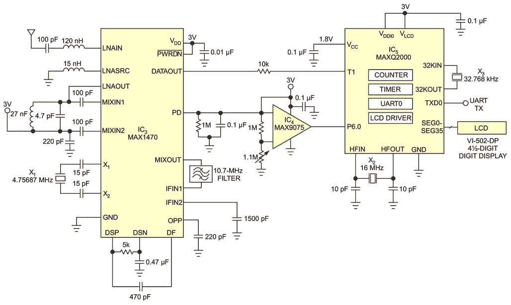

Figure 2. An ASK receiver with a microcontroller processes and displays temperature data.
Comparator IC4 connects to IC3’s RSSI (received-signal-strength indicator) with an internal peak detector. The external RC follows the peak power of the received signal and compares it with a predetermined, resistor-voltage-divider-generated voltage level. Lab experiments show that a threshold of approximately 1.57V generates a valid output on the data-out pin without receiving false readings. Adjust this threshold to the proper level for optimal performance. The comparator’s output is low when the received signal is weak or invalid and high when the received signal is adequate.
Microcontroller IC5 then measures and displays the value of the signal frequency using its integrated timer/counters and LCD-driver peripherals. A counter tracks the number of rising-edge transitions on the input temperature signal, and a timer tracks the elapsed time. After the timer’s 1-sec period elapses, an interrupt occurs. At that moment, the circuit reads the counter value, converts it to Celsius, and displays it on the LCD. The counter then resets to zero to restart the process. The timer automatically reloads once the timer interrupt occurs. UART0 also outputs the resulting temperature. A handheld frequency counter verifies the temperature reading.
The microcontroller monitors the signal power through P6.0, a general-purpose input pin. When the input is logic low, the LCD and UART output “no RF” to alert users of possible transmitter issues when the transmitter and receiver are too far apart from each other. The LCD connection follows the design in the IC’s evaluation kit (Figure 3). Using a look-up table in the data segment of the assembly code enables you to preserve the internal mapping of the display’s A through G segments. This preservation ensures that the display enables the correct segments. Using an RS-232 level converter, the UART output sends data to a data-logging device, such as a computer.
