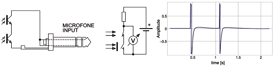

The question is how we can connect two phototransistors to the typically monaural microphone input to start and stop our timer. It is pretty simple: just connect the two phototransistors in series as shown in figure 1.
Figure 1. The microphone input of a PC can monitor two serially connected phototransistors. A simplified equivalent circuit is shown in the middle. If the light is blocked from any of the phototransistors, a voltage pulse will be measured at the microphone input. Pulses caused by two light interruptions are plotted on the right hand side.
If any of the phototransistors is blocked from the light beam, a voltage pulse will be generated at the microphone input that can be easily detected by software [4]. To ease mounting, the phototransistor can be fixed on a clothes peg, and even a simple ruler can be used to control the distance between the detectors quite accurately (see figure 2).

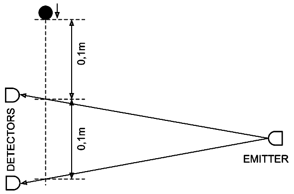

The performance of this stopwatch has been tested in a free fall experiment. A single lamp illuminated the two detectors from a distance of 0.5 m. The timer was started and stopped at 0.1 m and 0.2 m from the initial position, respectively. We have taken into account that beams from the light source reach the two detectors at different angles. The realisation of the experiment is illustrated in figure 3, while the arrangement and experimental data are shown in figure 4.
Figure 3. The setup of the free fall experiment. The serially connected phototransistors are plugged in the microphone port directly; an electromagnet is used to drop the steel ball in front of the phototransistors. Although the mains lamp has quite high AC component, the sharp peaks generated when the ball blocks the light from the detector allow high accuracy event detection. The software displays the measured time and the number of detected events. All values are stored and can be copied into any spreadsheet software by 2 or 3 clicks.
