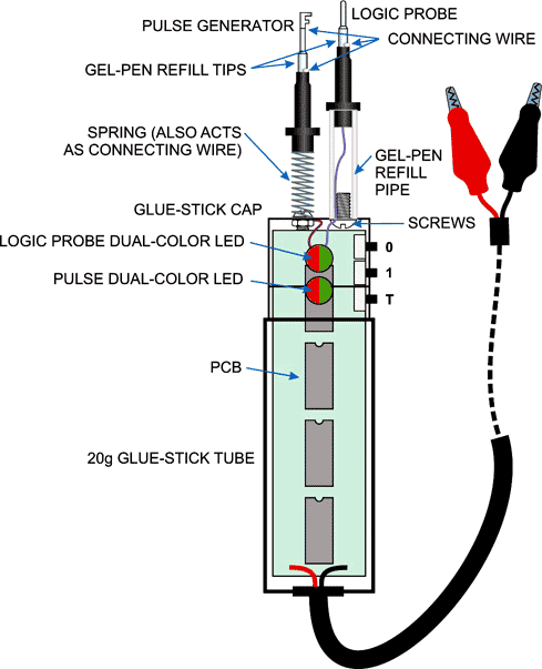

This Design describes a simple yet powerful handheld probe that you can use as both a logic probe and a pulse generator either individually or simultaneously. This feature makes the probe useful for testing DIP digital ICs, such as gates, flip-flops, and counters, using a socketed fixture with three-post jumpers to connect each pin to logic high or logic low or to 5V or ground. Three pushbutton switches, two dual-color LEDs, and two probe tips are built into a plastic cylinder, such as an empty 20g-or-larger glue-stick tube. The generator’s probe tip hooks to fit onto the test fixture’s jumper pins and mounts onto a spring, such as those in retractable ball-point pens, for flexibility, and it allows the logic-probe tip to move to the output under test. Two of the pushbutton switches set the generator’s quiescent state for a high output or a low output. The third switch briefly single-pulses the output to the opposite state. If the switch is pressed for longer than 2 seconds, the output produces a pulse train.

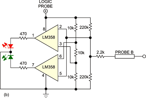

The LM358 acts as a window-detector logic probe (Figure 1b). With the values in the figure, the red LED lights at Probe B voltages of less than 35% of the supply voltage, and the green LED lights at voltages greater than 65% of the supply voltage. Neither LED lights between these voltages. You may wish to adjust the resistor network to reduce the lower threshold to include the transistor-transistor-logic zero of less than 0.8V.

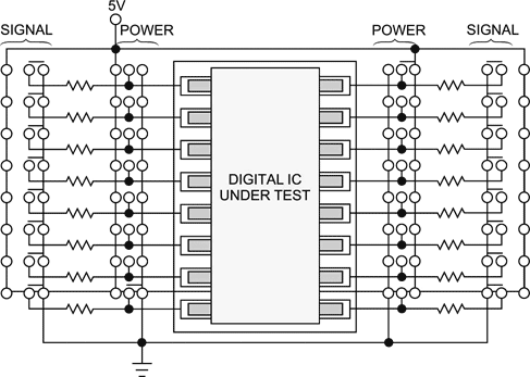

Figure 2. Program this test jig with header posts and jumpers for the IC under test.
Figure 2 shows a jig for testing the digital ICs. You configure the 16-pin DIP socket for the device under test with an array of triple-post headers and pushon jumpers. You can connect any pin directly or through a resistor to power or ground to configure power or logic levels. The resistors can be any suitable value; approximately 2 kΩ is appropriate. To set a TTL low, the pin must connect directly to ground. To inject a signal, hook the flexible spring-mounted generator, Probe A (Figure 3), onto the appropriate input post and then move logic Probe B to the corresponding output post or pin.

Figure 3. To inject a signal, hook the flexible spring-mounted generator, Probe A, onto the appropriate input post and then move logic Probe B to the corresponding output post or pin. Figure 2 Program this test jig with header posts and jumpers for the IC under test.
