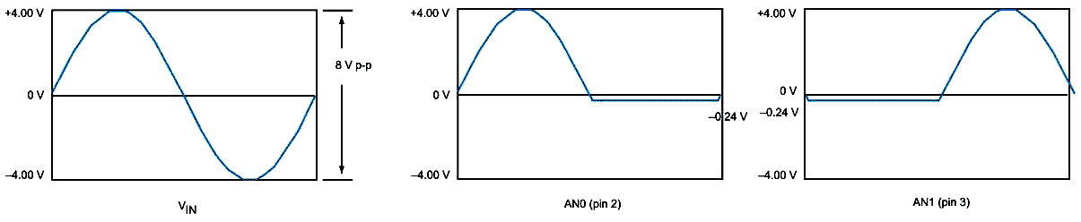

When VIN is positive – say, +4.00 V – U1A will present +4.00 V to AN0. Meanwhile, U1B will have –4.00 V on its output but the low-voltage-drop Schottky diode clips the negative voltage seen at AN1 (U3, pin 3) to about –0.24 V. Similarly, if VIN is –4.00 V, U1B will present +4.00 V to AN1 while D1 clips the –4.00 V from U1A to about –0.24 V at AN0.
Clipping the outputs in this way prevents a signal more negative than –0.30 V from appearing at either ADC input. Too negative a voltage at one input could cause current injection that would alter the other ADC channel’s results. The sample waveforms show a symmetrical 8-V p-p sine wave at VIN with the corresponding signals seen at the two ADC input channels (Figure 2). The ADC will read any value equal to or below 0 V as zero.

Figure 2. The ADC channels each see only one half of the input sine wave’s bipolar signal as a positive voltage.
