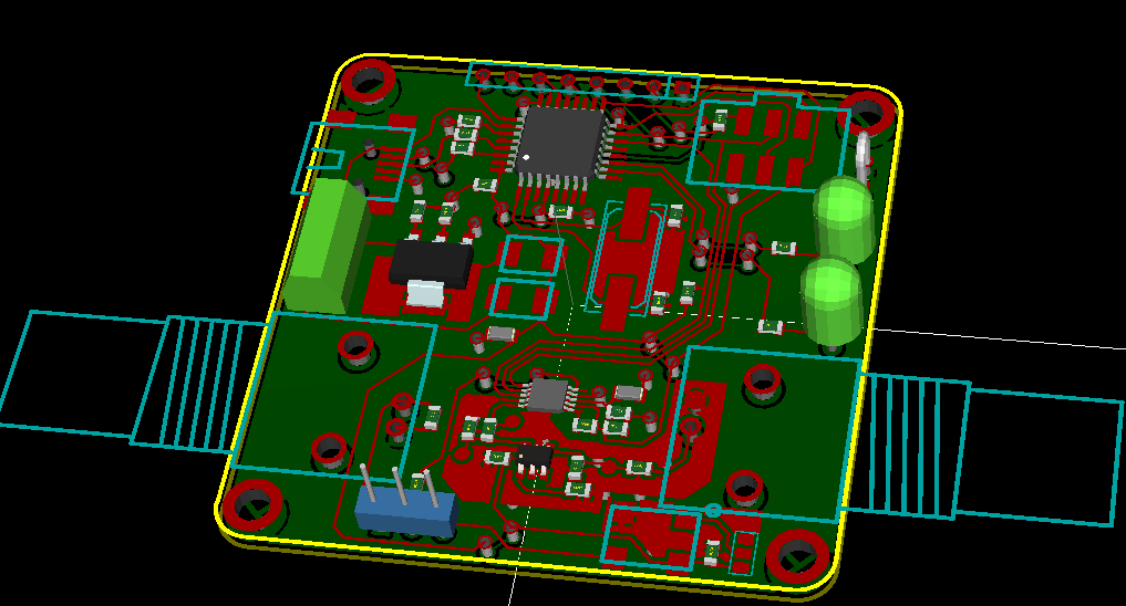

PCB design
The PCB layout was pretty straight-forward. Here's a screenshot of the final PCB in 3d-view of KiCad.
You can see the BNC connector for the external clock in that screenshot, that I haven't bothered soldering at least so far.

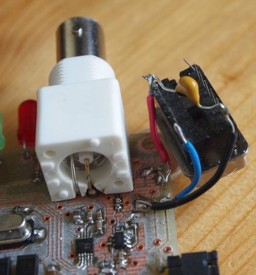

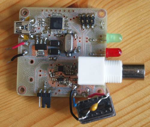

I designed the PCB to hold a surface mount oscillator, but didn't have one with the right output frequency. I did have the right oscillator in DIP package, so I just bodged it on the board like this:
Навесной монтаж осциллятора в DIP корпусе на печатную плату DDS генератора
A bit ugly, but works just the same.
I also had a small error in the original design. The VUSB pin of the AVR should be connected to the supply voltage, not the USB VUSB. That way, if I power the device from external power without USB, the USB peripheral can still get power and can be initialized. A simple cut trace and a solder bridge was enough to fix that. The error is fixed in the schematics I've posted here and on github.
