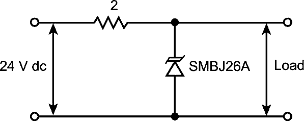

Figure 1. Using only the suppressor diode in this circuit that has a 2-Ω source resistance creates too high a peak transient current.
In the example circuit, the load, which can be the input of a logic device, is fed by a 24-V dc input, which can be from a sensor, transducer, or other device (Fig. 1). The source resistance is 2 Ω and the failure threshold is 36 V. The circuit uses an SMBJ26A 600-W transient voltage suppressor. If a malfunction causes a peak surge of 150 V with a duration of 10 ns at the inputterminal, the suppressor must clamp that surge at 36 V or less. The current delivered by this transient is:
  (1)
The suppressor causes the surge voltage to be divided between the source impedance and itself. Equation 1 shows that the higher the clamping voltage is, the lower the surge current in the circuit. Unfortunately, the resulting current in this example would fry the circuit.

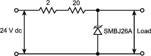

A higher wattage suppressor could be used, but that is not advisable because the high power capacity and power dissipation would be a costly solution. Alternatively, you can add a small resistor in series with the source impedance, effectively reducing the surge current and along with it the overall size, power dissipation, and cost of the circuit (Fig. 2).
Inexpensive Solution Protects Sensitive Devices From Surges
Figure 2. The addition of an inexpensive 20-Ω resistor to the input greatly reduces the surge current and power dissipated.
Assuming a small load, 10 mA, the voltage drop across the 20-Ω would be:
  (2)
Therefore, the surge current I would be:
  (3)
The added resistor reduces the surge current to less than 1/10 of the surge current without the resistor. The low-power suppressor can handle this current. Also, the clamping current is less than the rated current. The clamping voltage is:
  (4)
From the SMBJ26A datasheet, the maximum clamping voltage, VC(max) = 42.1 V; the maximum breakdown voltage, VBR(max) = 31.9 V; and the maximum peak pulse current, IPP(max) = 14.3 A. Using these values and the result of Equation 3 for Ip, Equation 4 yields VC = 35.5 V.
Thus, the clamping voltage is a little below the threshold voltage at 25°C. For higher temperatures, de-rating parameters must be considered. The steady state power dissipated by the 20-Ω resistor is:
  (5)
Consequently, a 1/8-W carbon composition resistor can be used for the suppressor circuit for the given pulse condition. This small series resistor drastically improves the suppressor performance with little cost impact.
